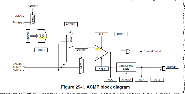

i am using ke06z128vlk4 mcu,and i would like to know, which pin is DAC output pin in mcu.
Refer the attachment(screenshot.png), as in the attachment ==>   PTA0 pin is for ACMP0_IN0
then which pin will be for DAC output.
I have also attached the reference manual of ke06.
 Thank you

Sorry. There is not DAC output pin.
The 6-bit DAC is 64-tap resistor ladder network which provides a selectable voltage reference for applications where voltage reference is needed.
which provides a selectable voltage reference for comparator.pngFigure 25-1. ACMP block diagram.png
