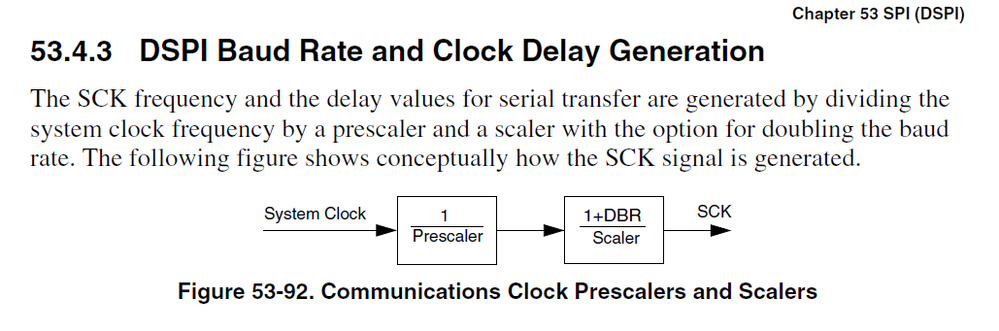

What do you meant by prescaled system clock ?
My SPI2 is connected to serial flash and core clock is 120Mhz. I want to calculate SCK baud rate using formula SCK baud rate = ( fSYS /PBR) x [(1+DBR)/BR]
PBR =2 DBR=0 and BR = 2
What is meant by prescaled system clock?

Hello undale,
Which chip do you use ?
The  fSYS means the system clock or bus clock .
Hope it helps

meedandeys
DSPI module is clocked from Peripheral Clock, hence FSYS refers to peripheral clock. Please refer to Clock Architecture of your controller reference manual to understand the relationship/configurations of SystemClock to PBRIDGE clock.
I hope this helps.
