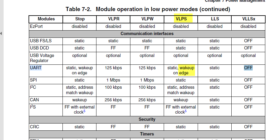

kerryzhou
Hi Reena Patel,
  Mark's reply is totally correct!
  UART3 can't work under the VLLS1 mode, please also note, VLLS1 recovery method is wakeup reset.
About the UART can be waked up power mode, please check the following picture.
