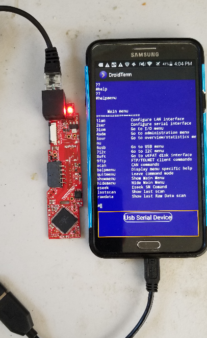

The USB operation is compatible with Windows, Linux, including Rasberry PI or Android (see image below) of a K64 talking to Android.
