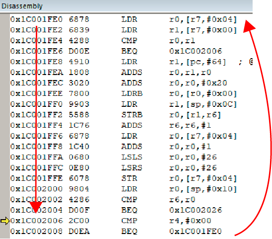

I use a MKL17Z64VFM MCU,when i run debug, system enter BOOT ROOM mode,and it is a endless loop,Should i how to set FOPT ?
I hava try to many combination,But result is same.

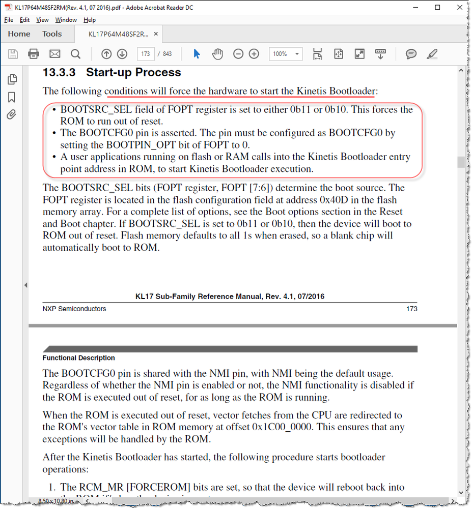

Please read "13.3.3 Start-up Process" of KL17P64M48SF2RM and then check these conditions:
Robin
2,177 Views
thoomanwang
Contributor V
because the board is my manual solder,i do not find a tin ball link NMI to gnd
