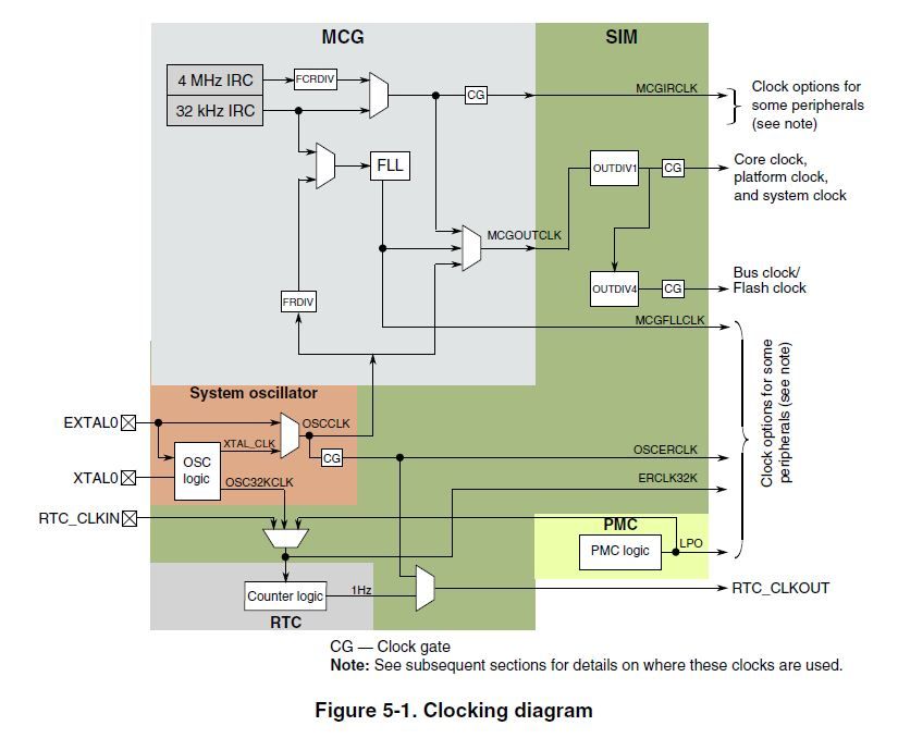

Hi all,
       I want to start using "MKL04Z32VFM4". I have used kinetis k series before. I have 2 question before design PCB. If anyone help me, I appreciate.
1) Is it possible to use 4mhz fast internal oscillator as system clock.

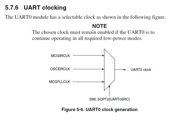

2) I want to use UART module at 1000000 (1Mbaud). is UART module of this MCU capable of running this baud rate.
- I used PE to use internal fast oscillator and setting uart to 1Mbaud, I did not faced with problem. I just want to get confirm before designing PCB.

Dear Okan ERCAN:
For your first question I guess you are ask because of the 4MHz IRC internal generator on the MCG, in this case you cannot use this clock directly as system clock, please see on the clocking diagram, if you want to have a system clock you should configure which Input signal you want for MCGOUTCLK and then configure OUTDIV1 and CG to get the specific system clock frequency you want.
For UART case you will notice that formula to calculate bad rate not only depends of the clock source for UART module, you should also consider OSR (UART0_C4[OSR]) and SBR (UART0_BDH[SBR] and UART0_BDL) values, as is described on the formula:
Baud Rate = Module clock / ((OSR+1) x SBR)
You need to consider all these parameters to verify if you could achieve a specific baud rate, based on the frequencies normally used on this module the common used baud rates (like the ones in the baud rate list on the hyperterminal) could be achieved, please also verify which module clock have you selected.

jeremyzhou
Hi Okan
Thank you very much for your focus on Freescale Kinetis product. I am glad to provide service for you.
After read KL04's reference manual, I'm sure that your assumption could work out.
If you have any other questions, please feel free to contact with me.
