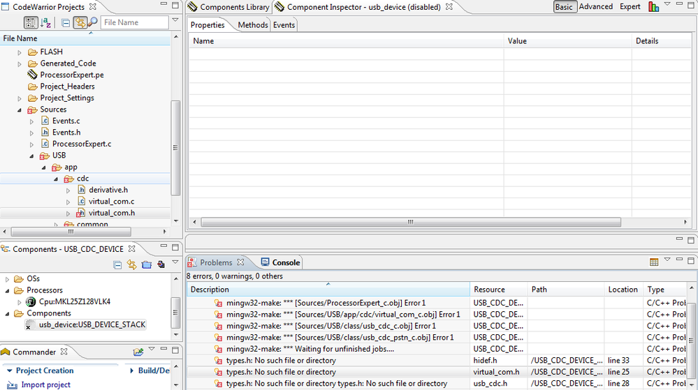

I imported  USB_CDC_DEVICE_MKL25Z128_PEx into CW 10.3 and when I try to build the project I get a lot of path error issues.  What is the best way to fix this?

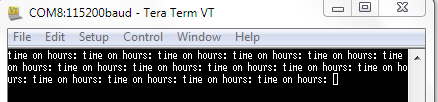

Gentlemen, this is much more stable then what I had working, but there still is a glitch. See attached subroutine It uses just about all that you provided.  I didn't add the delays since there is other microcontroller code running in Main() that will add that time with other code execution.
For test purposes I defined Time_On_Hours = 0xffff;
Problem:  each time I hit <return> in Hyperterminal, I see "time on hours:" but no value is printed for it AND
UTIL1_strcat(buf, sizeof(buf), (unsigned char*)"\r\n"); doesn't seem to be bringing the cursor back to the beginning of the line.

Getting closer, I imported usb device stack but now missing some include files such as usb_cdc.h and usb_framework.h
I added usb_cdc.h and now it can't find descriptor.h
10,252 Views
steve_fae
Senior Contributor I
did you mean to say import usb_cdc_class instead of usb_device_stack?  thanks for your help btw
10,252 Views
LuisCasado
HI
No, I mean the CW project. You only need the device stack PE component and you already have imported it. Try to remove the project from workspace or just switch to different workspace and import again the application project
Luis
10,252 Views
steve_fae
Luis, have a nice cold one on me.  I created a new workspace, re-imported the project and it compiles with only 27 warnings!  hehe

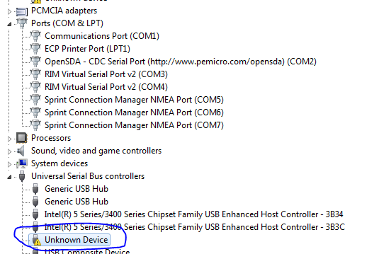

ok, now running project on FRDM board using Open SDA interface.  As you can see from my Device Manager
Open SDA enumerates to CDC on com2 but the other usb connection that connects directly to the KL25 doesn't enumerate properly.  Any ideas how to get it to enumerate to CDC?  Is the OpenSDA connection going to be a problem?
