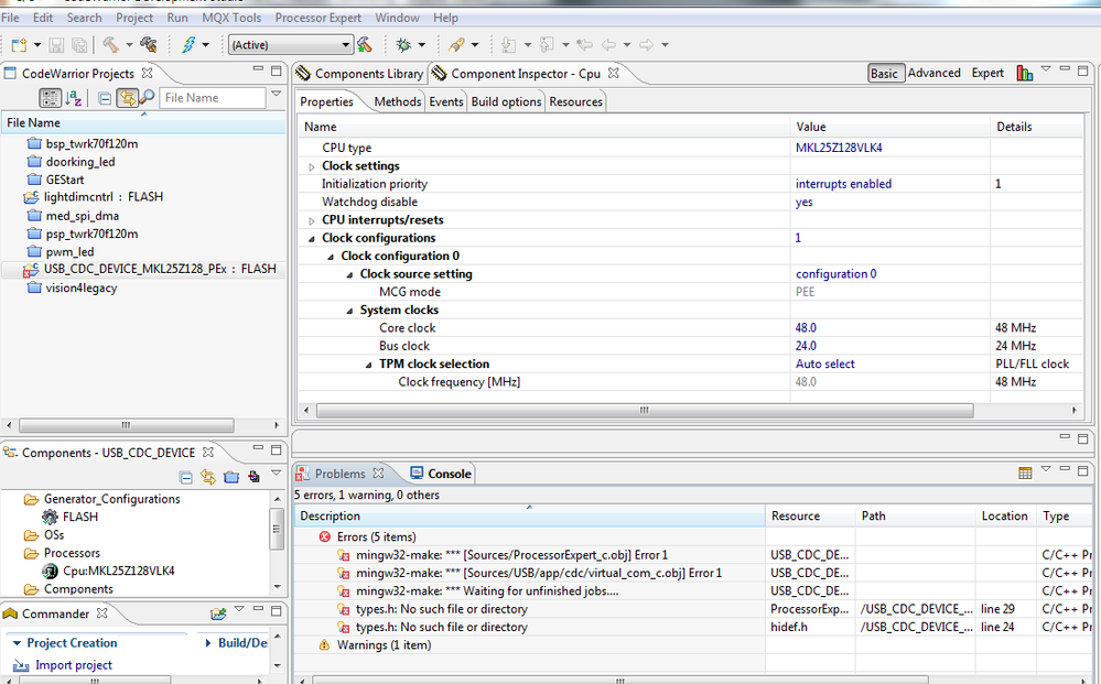

I imported  USB_CDC_DEVICE_MKL25Z128_PEx into CW 10.3 and when I try to build the project I get a lot of path error issues.  What is the best way to fix this?

LuisCasado
Steven,
Just tested the same project in 4.0.3 version and works fine.  Please download and try that version.
Luis

steve_fae
Senior Contributor I
Hey Luis, so I tried 4.0.3 and still get compile issues after importing project

LuisCasado
I don't remember if I had that issue. Please, backup your proyect and unzip the attached. I assume you have imported the PE Device stack into CW10.3.
Luis

steve_fae
I imported your project and did a clean and build.  same problem.

LuisCasado
Did you import the PE package from 4.0.3?
Luis
7,744件の閲覧回数
steve_fae
I just imported the .project into CW.  nothing else.
7,744件の閲覧回数
LuisCasado
Steven,
You missed to read the "Freescale Processor Expert USB Components Quick Start Guide" doc.
Processor Expert -> Import Package - > Select C:\Freescale\Freescale USB Stack v4.0.3\ProcessorExpert\Components\USB_DEVICE_STACK.PEupd -> Open
Rebuild the project
Luis

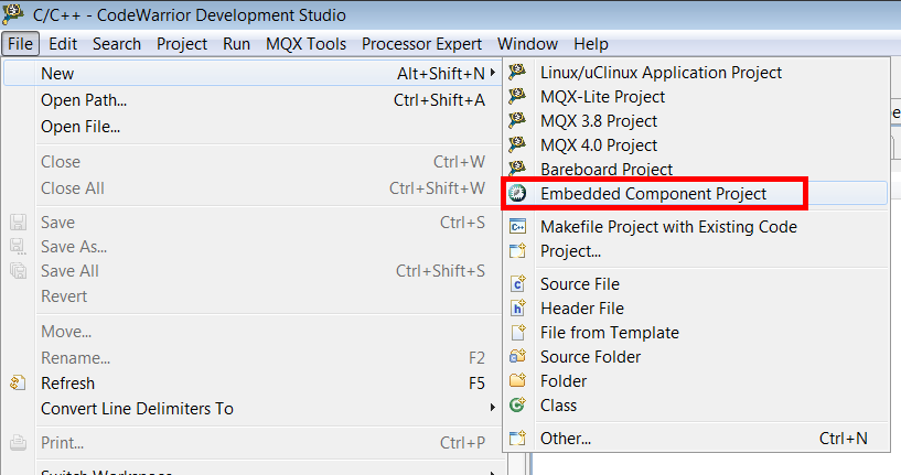

JimDon
Senior Contributor III
In case anyone else wants to read this:
USBPEXQSG.pdf  =  USB Processor Expert Components Quick Start Guide
It is include in the 4.0.3 package here:
http://www.freescale.com/webapp/sps/site/prod_summary.jsp?code=MEDICALUSB
A question. The document says:
"On Component Wizard, chose File-> Import-> Import components form package… as the
following figure."
I can't find any "Component Wizard" in 10.3 ? What do mean by "On  Component Wizard" ?
What "form" am I supposed to use? Do I  fill out a form? I
7,744件の閲覧回数
LuisCasado
Hi Jim,
Component wizard allows you to create custom PE components. Now is integrated in CW10.3
Luis
7,744件の閲覧回数
JimDon
Luis,
Except you must have a special license to use that, so I do no think that is the correct answer.
I get "A Valid Component Development Environment License was not found". when I try that.
7,744件の閲覧回数
BlackNight
Freescale has released a free Community license for the CDE (Component Development Environment), see this wiki.
7,744件の閲覧回数
JimDon
Thanks for the tip Erich. I could use that!
However the correct answer is:
Use Processor Expert/Import Package browse to the PEupd file and import it.
The document "Freescale Processor Expert USB Components Quick Start Guide" is out of date and misleading.
