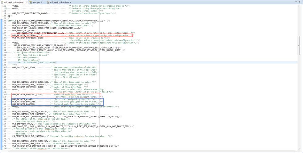

Basically, You have to define how many interfaces your device uses, what kind of class the device is, etc. In the example that i mentioned, this is defined here:
I would recommend to check this example and if you still have any doubt do not hesitate on contact me!
Isaac

I thank you. Printer board (MKL26) is working with the modified code that you have mentioned.
Windows PC is displaying “USB Printing device has connected” when I am connecting printer device.
