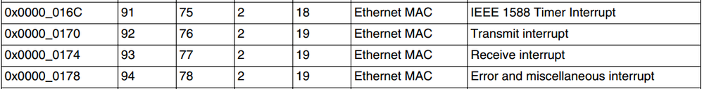

hi,
    The Ethernet works fine in k60 ,But now we replaced k60 with k66, the same code is not  working in k66 the interrupts are also not occurring , Any changes we needs to do for initialization part

Iam using keil5, We are giving external clock on EXTAL( pin.no 72) for both phy(lan8710 in RMII mode) and processor but we are not getting any interrupts .

After compare the captured the packet, we can figure out the difference of ethernet application between the K60 and the K60.
And I think I miss one thing, the ethernet related interrupt vectors are different between the K60 and K66.
                                                                                    Fig K60
                                                                                        Fig K66
Hope it helps.
