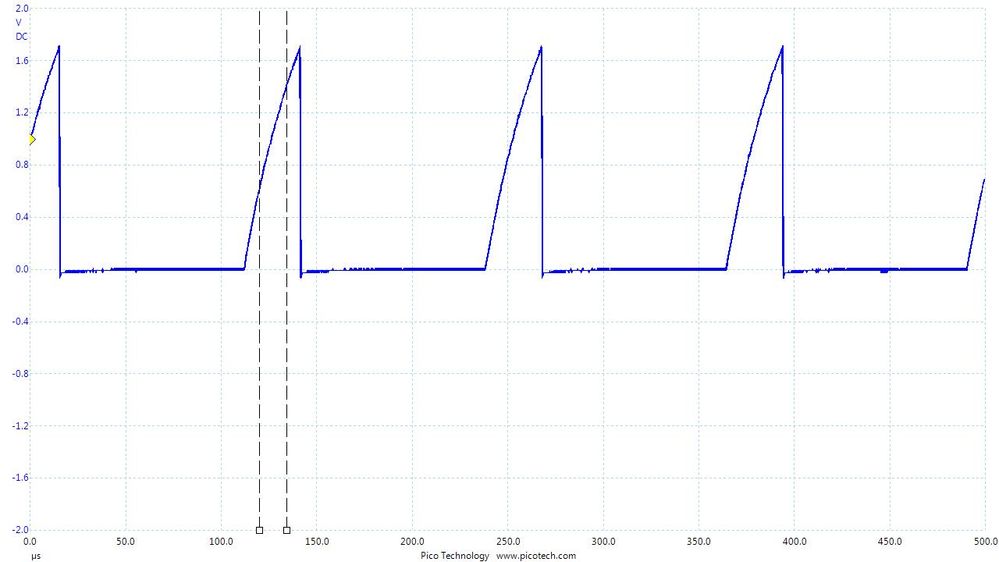

I seem to have got my usb-kw41z into a state where it no longer works.  When I observe RST_TGTMCU_b, I see the attached waveform.  I have checked the supply rail (P3V3_KW41) and it looks fine.  When I drag and drop a new .bin file into DAPLINKBOOT, after a delay of about 45 secs, the file "FAIL.TXT" appears.  This says "The transfer timed out".
From the waveform, I am guessing that every time (internal) reset is released, something happens which causes it to be re-asserted shortly afterwards.  Is it possible that I have inadvertently programmed a flash location which causes this?  If so, is there any way to undo it?

It appears that the signal I observed on Nreset is not particularly unusual - I have found that simply mass erasing the flash (ie. putting the chip back to its factory state) causes the same periodic behaviour.  The important thing I have realised is that the periodic behaviour on Nreset does not prevent the SWD from working - and once the flash is programmed with a valid application, Nreset behaves as you'd expect it to.

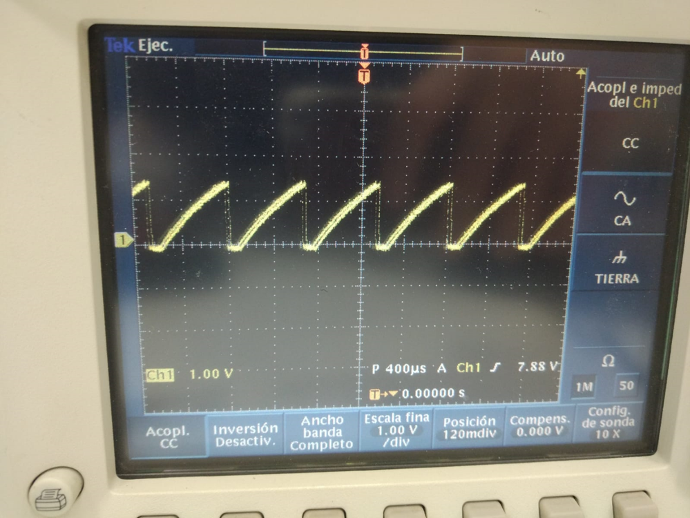

I have the same reset problem with the attached waveform:

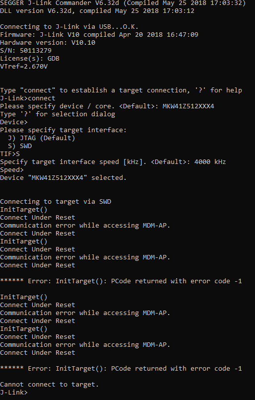

In my case when I try to debug I obtain the following image:
And I can not program my KW41Z module. I have not used a usb-kw41z, I have made a custom board with the kw41z. How did you solve this problem? Did you get the same debug error?
I am using McuExpresso and can not see the option you said "flash configuration field", how can i flash the module with this IDE?

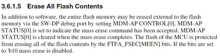

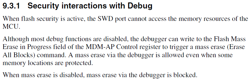

It seems I have the same problem than you. I have taken a look at "mass erase" in the MKW41Z reference manual and I think all blank modules are in secure state by default. KW41Z can not be debuged at first via SWD (the debug port has no access to memory locations in secure mode), but we should be able to access to the CPU flash and the programmer interfaces are only allowed to launch mass erase operations.
