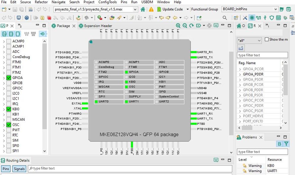

Hello friends, I have a board that I designed with the MKE06Z128VQH4 microcontroller, in which I am using several outputs and inputs. I am using one KBI input, 3 timers, and one counter, so there’s no problem there — I’ve already done the configurations and they work.
I am currently working on the UART0 serial port, where I connect a USB-TTL serial adapter to the PC to receive or send data. I haven’t been able to make it send or receive information using the SDK libraries. My configurations using MCUXpresso are as shown in the image:mk1.JPGmk1.JPG

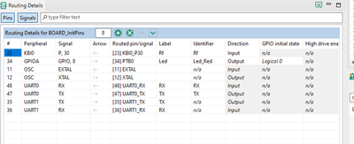

the pins:

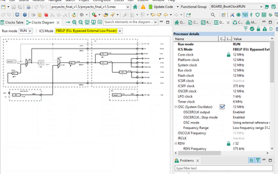

the clock, i have a external crystal 12MHZ:
i can´t put the FEE option because the FLL have error, then i doing the configuration with FBELP.

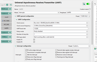

In the UART0 i doing the configuration with interrupt receive and transmitt polling.

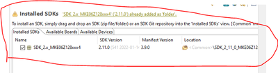

the sdk installed is:

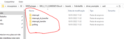

i have the example sdk:
With those examples I still can’t get UART0 to work. I need some guidance — I’ve been trying for several days to get UART0 working.

1) Regarding the clock, please check whether your 12 MHz crystal is functioning properly, and verify the configuration.

Please first test the UART demo. Does the UART demo work properly on your side?
Make sure the hardware connections are correct. Connect the proper TX and RX pins.

hi alice! I tested with the demo using polling and it doesn't work.

Hello @Iotelctronic
Please use the demo as it is without any modifications.
I have tested it on my side and found no issues
