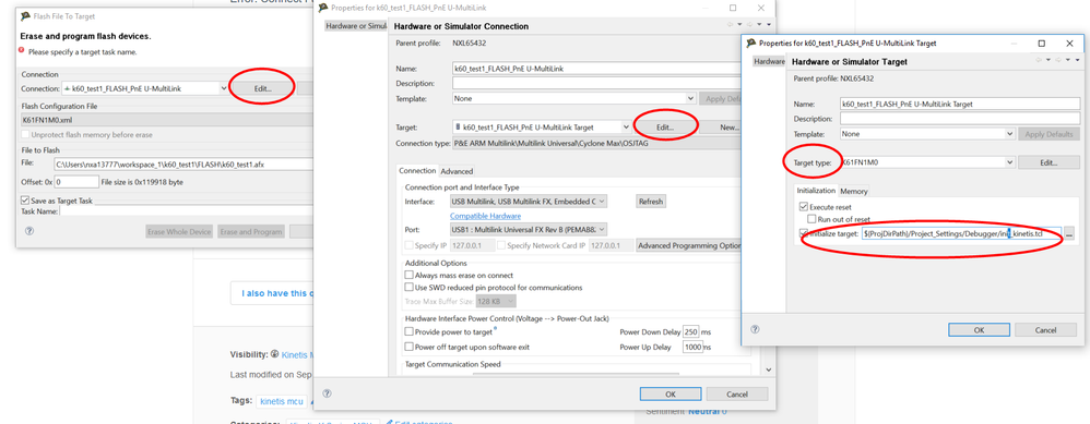

We are using Codewarrior 10.6 trial version. We have a board with "MK61FN1M0VMJ12" microcontroller. There is a problem while programming with Universal Mutilink 2.0.
The error while launching Internal flash configuration is as follows:
___________________________________________________________
fl::target -lc "LC for Simple Flash"
fl::target -b 0x1fff0000 0x20000
fl::target -v off -l off
cmdwin::fl::device -d "FTFE_PFlash1M0" -o "128Kx64x1" -a 0x0 0xfffff
cmdwin::fl::image -f "E:\\CW_WORKSPACE\\DCC_03082017_bel demo final\\MK70FN1M0_INTERNAL_FLASH\\Aslesha_Card_Test.afx" -t "Auto Detect" -re on -r 0x0 0xfffff -oe off
cmdwin::fl::erase image
Beginning Operation ...
Auto-detection is successful.
File is of type Elf Format.
Performing target initialization ...
Error: Connect Failed.
Can't connect. The Debugger can not connect to the P&E device(ARM GDI Protocol Adapter)
____________________________________________________________________________________
Earlier, we have tried to do the same process with CW 11, 10.7 versions also but no success could be achieved. We encountered the same error.

Hello Hemanth K,
How about programming a simple project ? And can it debug well using the debugger ?
If still can't work , please check debug configration and flash program configurations:
