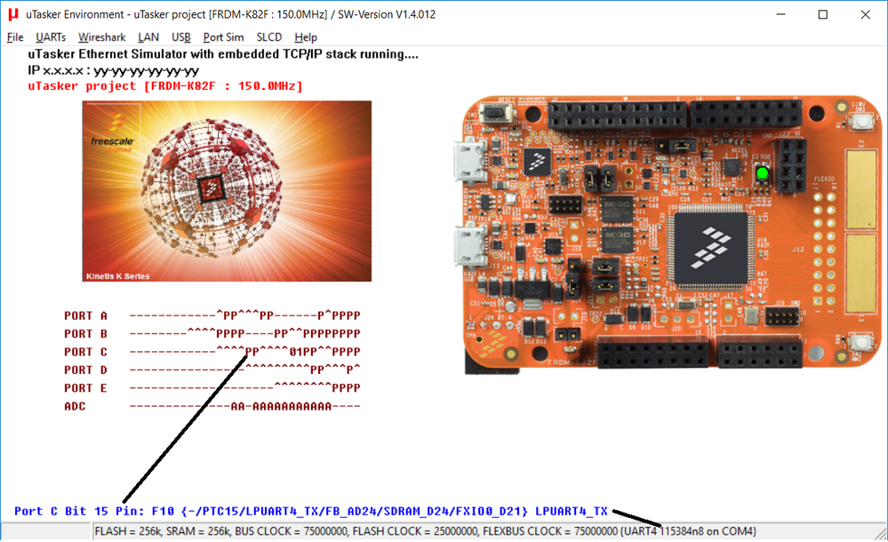

Load the binary application at http://www.utasker.com/kinetis/FRDM-K82F.html to your FRDM-K82F board.
It LPUART connects to the OpenSDA VCOM interface at 115200Baud and supplied a command line menu interface. In its UART menu you can command different Baud rates too.
In the I/O menu there is also a memory debugger interface where you can read internal registers to see how they are setup (or else use a debugger).
Like this you can see how the LPUART is set up for each of the Baud rates.
