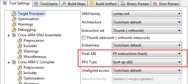

Dear Sir
K60 microcontroller has inbuit FPU, So it support floating point instuction by hard ware itself rather than softcode
I am using KDS for K60  and i using sqrtf() function in .list file it shows software root function. as below
****b_out = sqrtf(a);
  82              .loc 1 82 0 discriminator 1
  83 0036 40F20003movwr3, #:lower16:a
  84 003a C0F20003movtr3, #:upper16:a
  85 003e D3ED007Afldss15, [r3]
  86 0042 B0EE670Afcpyss0, s15
  87 0046 FFF7FEFFblsqrtf
  88 004a F0EE407Afcpyss15, s0
  89 004e 40F20003movwr3, #:lower16:b_out
  90 0052 C0F20003movtr3, #:upper16:b_out
  91 0056 C3ED007Afstss15, [r3]
  83:../Sources/main.c ****timecount = timecount+1.2;
1.can somebody say how to invoke floting instuction ?
2. is possible to do square root by excecuting sqrt hardware instruction? if yes then how.

In the compiler settings, make sure you have these options set:

MK60FX512
There are option of setting FPU type whether hard or soft in KDS but if i set "Toolchaing default" then it is taking as software and generating branch  and software code without any FPU instrucation and not giving any error
but I set as
mfloat-abi=hard
mfpu=fpv4-sp-d16
from  project setting then while running it is giving Hard fault and haging at
PE_ISR(Cpu_Interrupt)
  /* This code can be changed using the CPU component property "Build Options / Unhandled int code" */
  PE_DEBUGHALT();
but same thing i tried in CW10/6 it is working and it generate FSQRTS instruction.
Please help to sort out issue of KDS.
Thanks and regards
Bipin

BlackNight
It looks like you have not enabled the floating point unit?
Add this code to your application
void vPortEnableVFP(void) {
  /* The FPU enable bits are in the CPACR. */
  __asm volatile (
    "  ldr.w r0, =0xE000ED88  \n" /* CAPCR, 0xE000ED88 */
    "  ldr r1, [r0]           \n" /* read CAPR */
    "  orr r1, r1, #(0xf<<20) \n" /* enable CP10 and CP11 coprocessors */
    "  str r1, [r0]           \n" /* store to new value back */
    : /* no output */
    : /* no input */
    : "r0","r1" /* clobber */
and call it in main() as the first thing.
