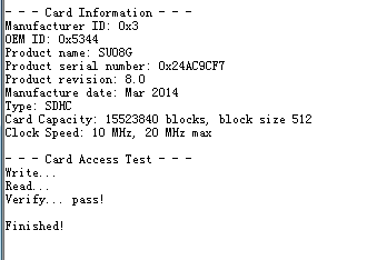

Hello Audi,
I have test your project on my side , and it can work well , the screenshot below is the information on hyperterminal.
Does i misunderstand your question ?
Alice

audi_mcavoy
Hi Alice,
Did you get it to work from KDS with the OpenSDA debugger?  Or did you drag/drop onto the mbed drive?
