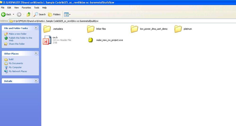

IAR and CW are different IDE tools , and the main difference is the compiler. So you can not directly import the source code for a IAR project into CW workspace, some definitions might be different and some might miss, To creat the CW based project, please run "make_new_cw_project.exe" in "Kinetis L Sample Code\kl25_sc_rev6\klxx-sc-baremetal\build\cw". Please kindly refer to FRDM_KL25ZSCG_CW.pdf in "Kinetis L Sample Code\kl25_sc_rev6" for more details.

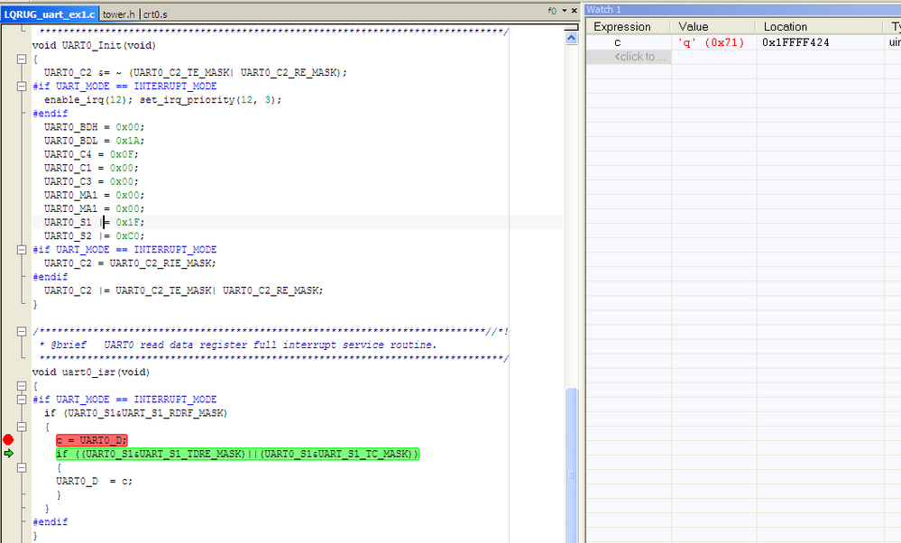

Paul_Tian
Hi, Manvitha
I tested project from path \Kinetis L Sample Code\kl25_sc_rev6\klxx-sc-baremetal\build\iar\LQRUG_uart_ex1. It can work well. Please reference following picture. As you can see, I use HyperTerminal and press character q, then c get the value of q.
I think your project might not be newest one, would you please help to download and test again. And also pay attention to baudrate is 115200.
Hope my reply can help you.
