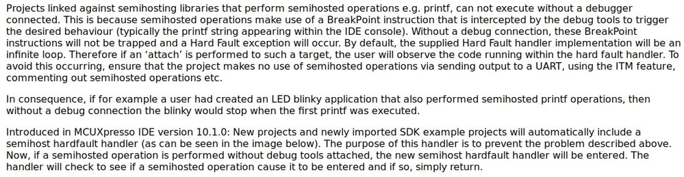

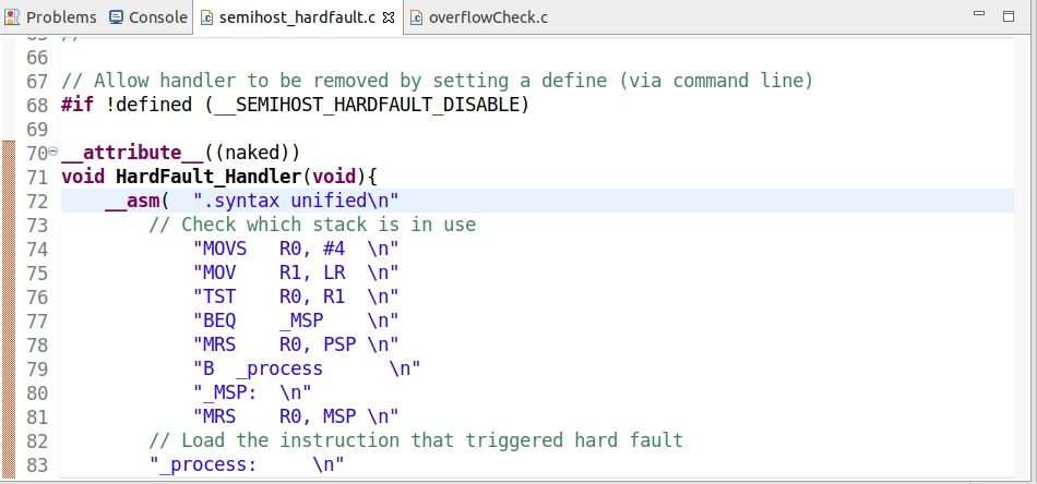

This thread got to be quite long before the solution became understood.  I am marking it as "Solved" so that anybody in the future looking to understand this issue will see that it hasn't been left hanging with more than 50 replies.
The problem was that I modified "semihost_hardfault.c" with code to turn on an LED to indicate that a "hard fault" occured.  When I put in the extra code, I was under the impression that the method was for out of bound conditions (this assumption was made because when I encounter an out of bounds write, execution stops at the start of "semihost_hardfault.c") and not as a tool to handle semihost error conditions.
I should have a) read the comments in the"semihost_hardfault.c" source file and b) not touched the file.
When I reverted back to the original code, the issues of the application going into an invalid state when "PRINTF" is encountered and no debugger active went away.
Don't change "semihost_hardfault.c"

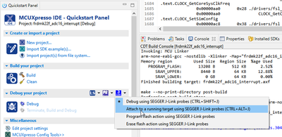

I would do an 'attach' to the target to see what is causing the stack overflow triggered. I suspect that it might not be technically an overflow but something writing to your stack. With the attached session you should be able to inspect the cause and what is on the stack and why it triggered. If it is a write to your stack from somewhere you should see the changed pattern on the stack. Then I would restart the application with a watchpoint (https://mcuoneclipse.com/2018/08/11/tutorial-catching-rogue-memory-accesses-with-eclipse-and-gdb-wat... set to that address or memory range to see what is writing to it.

As I said previously, I'm running on Linux and there doesn't seem to be an "attach" option (as you've outlined in Attaching to a Running Target with Segger J-Link, GDB and Eclipse ) in the programmer window - or do you know of one?  As I said, I think I've got to find a Win10 laptop with enough disk space to handle MCUXpresso.
I'm very familar with setting watchpoints, so the process sounds good, I just have to get development hardware that can support it.

that link refers to the Kinetis Design Studio, things are different for the MCUXpresso IDE.
I could swear I wrote about this feature, but now Google fails to find it (so I can blame Google?). Anyway, it is here:
I hope this helps,

do you print to a serial port or are you using semihosting?
If using semihosting, be aware that without a debugger attached it will cause a hard fault to be handled by your semihosting hard fault handler. It will add to the MSP (interrupt stack) (see https://mcuoneclipse.com/2016/08/28/arm-cortex-m-interrupts-and-freertos-part-3/ if this is new to you). So I suggest to increase the interrupt stack space. In MCUXpresso you can do this in the linker settings (there is a setting for the Stack under 'managed linker script').
I hope this helps,
Erich

That's really helpful - I'm using semihosting and the default.
I was aware of the two stack architecture in the Cortex-M but I thought that the task stack (PSP) was used during interrupts and the MSP was used within FreeRTOS to avoid adding to the process's stack data (and also simplify restoring the process's context information).

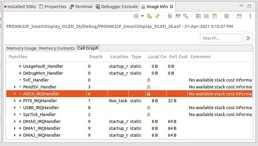

I recommend you check the interrupt stack size used with the Image Info:
It does not count in for the interrupt nesting (this is not something this view can account for), but if you know your interrupt priorities you should get an idea about the stack consumed.
And yes: that is the linker setting you showed responsible for the MSP stack size. 4k should be plenty, but who knows what your interrupts are doing?

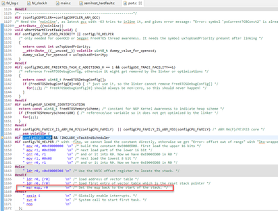

The other thought I have: do you reset the MSP stack at scheduler start? The NXP SDK standard examples are doing this, and if you have some data present on the MSP stack this will be not good.
See https://mcuoneclipse.com/2019/01/20/freertos-how-to-end-and-restart-the-scheduler/ on that topic.
That's why I have added
configRESET_MSP
to FreeRTOS to configure this. So check if you reset it,e.g.
So depending on this you have more (or less) usage of the MSP.

myke_predko
Senior Contributor III
Hi @ErichStyger
Well no luck with changing the stack value - I doubled the "Default" value to 0x2000 (4k) and I get the same behaviour.
I looked at the Call Graph for a previous build (which works without any issues) and the only difference I can see is the "ADC_IRQHandler" which is in the new project and not in the old as you can see here:
I'm a bit surprised the ADC Handler has a call depth of 8 levels - I'm using the SDK code which appears to be fairly inefficient - right @mjbcswitzerland ?
So, any suggestions on what to look at next?  Maybe I'm not changing the right Property?
8,282 Views
ErichStyger
Specialist I
Hi @myke_predko ,
can you share a picture of that ADC0 interrupt handler in the image info unfolded to see all the dependencies?
I'm wondering why it is not able to show the stack used unless it is implemented in assembly?
Erich

ErichStyger
Specialist I
Hi @myke_predko ,
the depth of this interrupt service routine should be "3" and not the "8" produced by the Call Graph (I guess I don't understand how it works).
It counts how many functions are called to the max and stacked up. Could you share the image as I did for that depth unfolded? Are there any printf() in it?
If it is as on my SDK example, the ADC16_GetChannelConversionValue adds up to the number of calls because of that assert in it.
Erich

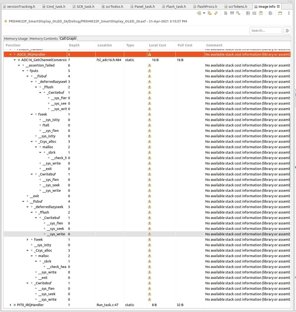

myke_predko
@ErichStyger
Here is the Call Graph Fully Expanded.
No PRINTFs in it.
myke
8,210 Views
ErichStyger
Specialist I
No PRINTFs in it.
Outsch! Even worse, you have file I/O in it (writing to a file) :-(.
Your assert must be pretty fancy
Erich
8,196 Views
myke_predko
@ErichStyger
I haven't done anything with the assert - this is all the SDK code.
When I look at the assert macro expansion I get:
((channelGroup < (uint32_t)(2)) ? (void)0 : \
__assertion_failed("/home/myke/MCUXpressoIDE_Workspace/FRDMK22F_SmartDisplay_OLED_26/drivers/fsl_adc16.h" ":" "486" " : " "channelGroup < (uint32_t)FSL_FEATURE_ADC16_CONVERSION_CONTROL_COUNT"))
I'm trying to find the source to "__assertion_failed".  Any ideas where I can find it?

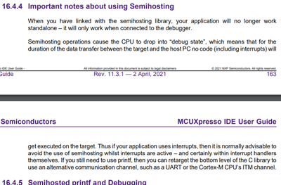

7,945 Views
jingpan
You can change library setting in Quicksart Panel
You can find this in MCUXpresso IDE user's guide.
Jing
7,934 Views
myke_predko
Hi @jingpan
Thank you - you helped me identify where the problem is.
When I read the section of the manual you've pointed out I see:
This describes basically what I'm seeing so you've identified the isse - see below.
I must confess, I never read through the semihost_hardfault.c comments - I honestly thought that its purpose was to catch invalid memory space accesses as when they do happen, the "fault" window becomes active and the "semihost_hardfault.c" file is displayed as:
So, looking at "HardFault_Handler" and not understanding it's context (or looking beyond the few lines that came up when there was an access issue), I added a write to an LED to indicate that the Handler had been invoked when the debugger wasn't connected.  I had tested it and demonstrated it worked when I forced the code to execute at an invalid location.  I added the LED write it a week+ ago and I didn't do my testing of the application with the debugger off until I had made a number of other changes so I assumed it was all right and it was the new changes that caused the problem.
If you've read through the entire thread here, you'll see that my plan was always to remove the debug "PRINTF" statements using a build variable so my question back to you is, is this appropriate or should I use something other than the default "Redlib (semihost-nf)" for "QuickSettings>>"->"Set Library Header Type"?  What do you recommend?  Right now, I'm debugging code on a FRDM-K22F board with added hardware but I will be using a custom board with a J-Link Plus programmer/debugger when the boards come in.

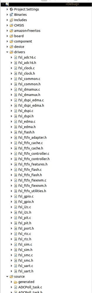

I can't find "__assertion_failed" anywhere in the project and I definitely can't find "fsl_assert.c".  When I click on it and hit F3, nothing happens.
Here is the project's "driver" folder where I'd expect it:
Any ideas where to look?
myke
