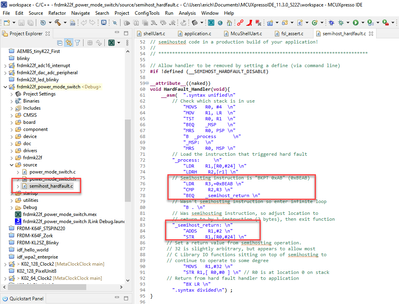

This thread got to be quite long before the solution became understood.  I am marking it as "Solved" so that anybody in the future looking to understand this issue will see that it hasn't been left hanging with more than 50 replies.
The problem was that I modified "semihost_hardfault.c" with code to turn on an LED to indicate that a "hard fault" occured.  When I put in the extra code, I was under the impression that the method was for out of bound conditions (this assumption was made because when I encounter an out of bounds write, execution stops at the start of "semihost_hardfault.c") and not as a tool to handle semihost error conditions.
I should have a) read the comments in the"semihost_hardfault.c" source file and b) not touched the file.
When I reverted back to the original code, the issues of the application going into an invalid state when "PRINTF" is encountered and no debugger active went away.
Don't change "semihost_hardfault.c"

ErichStyger
Specialist I
Hi @myke_predko ,
I think that recommendation Don't change "semihost_hardfault.c" is not correct.
Or maybe add "unless you know what you do" :-).
That semihost hard fault handler serves two purposes:
1) catch hardfaults and continue for cases where the application does semihosting without a debug session going on
2) catch all other hardfault handlers
I do modify that handler (most of the time I use the one in the McuLib), one just need to be careful with the assembly code to do it at the right spot, not impacting the semihost handling code.
I think the real recommendation should be
Do not use Semihosting or printf() unless you *really* know what you are doing
There is a place for semihosting (e.g. for File I/O on the host) or printf() for the very first 'hello world'. But otherwise it should be banned and never be used. As noted in the NXP semihost_hardfault.c:
// is meant as a development aid, and it is not recommended to leave
// semihosted code in a production build of your application!
I hope this helps,
Erich

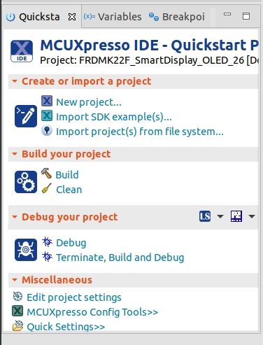

@ErichStyger
Replying to "this is not Windows related, it should work the exact same way on any MCUXpresso supported host."
Well this is a bit embarrassing, when I looked originally the way I have MCUXpresso set up, my quickstart menul looks like:
But, when I drag the right edge to the right:
I'll take a look at doing the attach.
Thanx.

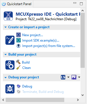

ErichStyger
Specialist I
On Windows I have a horizontal scroll bar like this:
17,218 Views
myke_predko
Senior Contributor III
@ErichStyger
Scroll bars:
In Ubutu, you have to look for them somewhat.  They kind of appear if you roll over them but to see them you have to be over them with the left mouse down.
I don't feel so terribly bad about not seeing it.

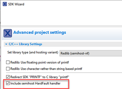

ErichStyger
Specialist I
"there shall be a special hard fault handler in your project (there is an option in the SDK project generation for it): look for that semihost_hardfault.c" I just looked at the SDK project builder and can't find it.  The only reference I can see in the semihost_hardfault.c code to changing it's operation is  "// Allow handler to be removed by setting a define (via command line)".  Can you be a bit more specific?
I'm referring to this:
There is an option in the project creation wizard to add it:
Erich
17,316 Views
myke_predko
Hi @ErichStyger
I'm replying to your comment about enabling the "special hard fault handler" by using the Advanced Project Options.
This is the default, so it's always available.
myke
