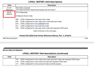

Hello,Can the GPIO of MKE13Z be set to push-pull output mode? The manual only mentions push-pull output in the LPI2C section, but it is not mentioned in the Ports Summary.

Hello @abyssnone ,
You can configure LPI2Cx_MCFGR1[PINCFG] bit to realize it.

Hello @abyssnone ,
The GPIO of MKE13Z cannot be set to push-pull output mode. Only LPI2C pin can be configured to push-pull output mode.

How can I configure the I2C pins to operate in push-pull mode? thanks.

Hello @abyssnone ,
