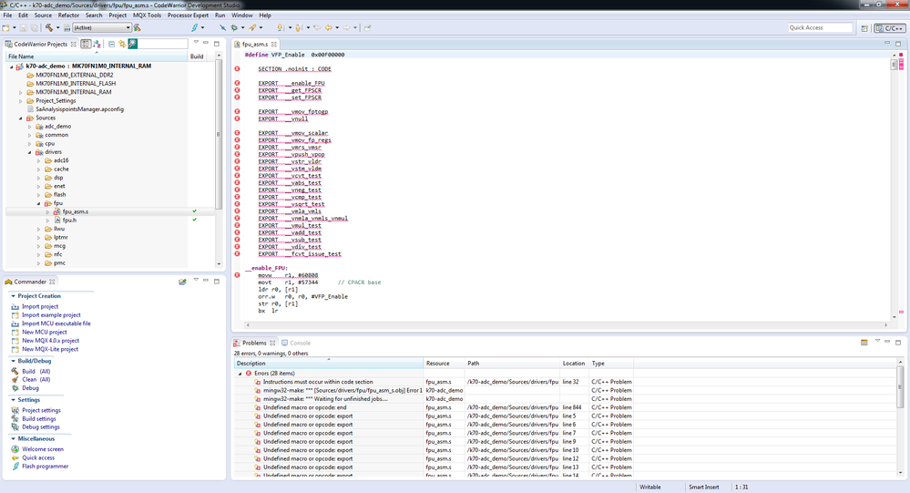

Hi everybody, I've downloaded a package of bare metal project examples for K70 MCUs and after build the "k70-adc_demo" as said in the "cw_readme.txt" file, I got 28 errors making reference to the FPU driver (fpu_asm.s) and
most of the errors say "Undefined macro or opcode: export  fpu_asm.s". How can I fix this??

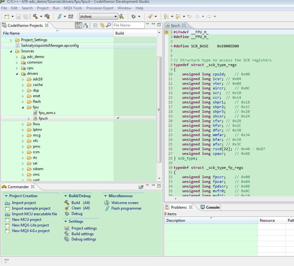

Hi Juan,
    Except delete the folder, there has another way to solve it.
    Just click the  draw behind  the fpu_asm.s, then rebuild it, there will no error appear.
    Like the following picture:
Wish it helps~!
Jingjing

Thanks for the reply Jingjing but I have tried many times and it doesn't work. My workspace path is: "C:\KINETIS_120MHZ_SC" and when I open the "k70-adc_demo" project (or any other) this is what I get:
I think is some problem when compiling the assembly.
I'm using the codewarrior for MCU, Version: 10.5, Build Id:130916.

kerryzhou
Hi Juan,
Wish it helps~!
Jingjing

juannava
Thank you very much Jingjing, it compiled successfully but there is another thing I would like to ask you because after compile this project the console show the following lines if I try to program:

PRJOY
Just right-click "dsp_asm.s"   --->  properties  ---> Setting  ---> Enable the option " Exclude resource from build"

kerryzhou
Hi Juan Nava,
    I checked it, you can delete the fpu folder directly.
    Then build it again, you will find the error is not exist.
    And I try the "k70-adc_demo" project based on IAR, it does not contain the FPU driver.
   So, just delete it!
   Any question , please contact with me!
Wish it helps!
