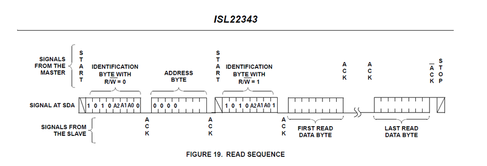

joey81
Hi Mark,
I have a home-brew I2C driver for the 150MHz K60.  I'm talking to an Intersil digital potentiometer (ISL22343).
The write routine works OK.  We can see the potmeter appropriately responding to what we write to it.  Reading back is a different story.  We can see the the data being clocked out from the ISL22343 at the 4th frame.read-sequence.jpg
However, the value we get from the I2C1_D register is always 0xFF, no matter what value the ISL spits out.
I don't have open drain enabled (ODE=0) on both SCL and SDA.
When I enable ODE (just like what the generated code of Processor Expert), it gets worse:  I get an arbitration lost error (ARBL=1) as soon as MST is set to 1.  Nothing comes out of the I2C pins.
I made a small project with nothing but the PE-generated code for I2C.  It also gets the same ARBL error.

mjbcswitzerland
Specialist V
Joey
It is difficult to imagine what would cause always 0xff to be seen at reception - I think that showing the code may help.
I don't have much experience with PE generated I2C code apart from debugging a case with reading accelerometer values each time its INT triggered: FRDM-K20D50M-Accelerometer Interrupt issue
During the tests I didn't have any major problems with the I2C itself but the code was a bit mashed up in my opinion (using blocking routines with interrupts), which made actual program design around it tricky if the internal workings are not correctly understood.
There is an I2C driver in the uTasker project which has been used on many different K and KL parts without any known issue in case you are looking for a solution which I believe will avoid any further problems: KINETIS Project Code
It also allows the I2C interface and slave devices to be simulated. The MAX543X (digital potentioment) is included in the slave device simulator and it is quite easy to add new ones if needed. I added the list of present devices below.

joey81
Here's the initialization code:
void i2c_initialize()

With this code, I get 0xFF
When I uncomment lines 13 and 14 (I understand ODE is a must), I get an arbitration lost error as soon as the K60's I2C module is set to master.
12,396 Views
mjbcswitzerland
Specialist V
The initialisation looks fine.
You do have pull-up resistors on the I2C bus don't you?
