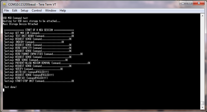

the program sends me error in the read and write command in usb host mode, when I run the example USB_MSD_HOST_MKL25Z128_PEx sends me the following result:
I've already tried three different usb stick and sends me the same result.I'm using the usb stack 4.1.1 help me

Hi Alejandro,
Are you using a TWR-KL25? or a FRDM_KL25? I´m asking this because the host must provide the 5V on VBUS and the FRDM-KL25 can´t do this natively (hardware modifications are required)
