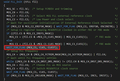

I downloaded the THREE-PHASE-POWER-METER-SOFTWARE from https://www.nxp.com/design/design-center/development-boards-and-designs/THREE-PHASE-POWER-METER and compiled it with IAR 7.8. After resolving the build errors, I was able to successfully download the program to the MCU.
However, in Debug mode, pressing the RUN button causes the program to stop and the debugger to disconnect. Stepping through the code shows that it falls into an infinite loop at the point indicated in the figure. Additionally, when the IRTC runs, the debugger connection is also lost.
How can this issue be resolved?

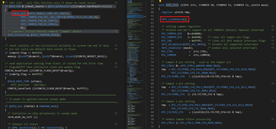

Over the weekend, I've been trying to run the demo software.
I installed IAR version 7.4 and tried to download the demo software without making any modifications. The only settings I changed were selecting the J-Link debugger and checking the "Use Flash loader" option.
I'm attaching the project which I just compiled. It compiled without any errors or messages.
However, when I attempted to download it, a warning message about a stack plugin appeared. Then, when I pressed the RUN button, the debugger disconnected, just as it did before.
I believed that the MKM34Z256CLL7 (used in the SCH-28709_A schematic I referenced) and the MKM34Z256VLL7 (which is on my PCB) were compatible. Could you please confirm if this is correct? I don't have an MKM34Z256CLL7 on hand, so I was unable to test it myself.
Could you please help me with this issue?
