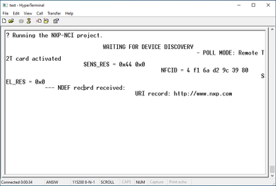

Hi @shane_mitchell ,
I am sorry but I could not reproduce your issue here, the project works well as expected, please kindly have my result as below:
BTW, did you use
OM5578/PN7150ARDM
with FRDM-K64 ? They can be connected each other via the Arduino interface.

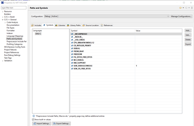

 these are the settings I am using the reply I get is
The OM5778 is plugged directly on to the nxp frm k64f board with no modifications I am programming via the usb port next to the reset button. Is there anything with the set up that needs changing.

Kan_Li
Is your project a custom project? The project name as well as the symbols are totally different from the released version.
Please kindly clarify.
Kan
