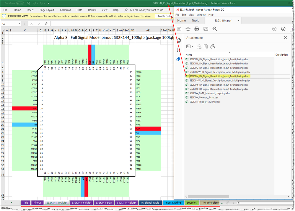

 please suggest pin to pin compatible alternative part in fs32 mcu- FS32K144HRT0MLLT.
also plz guide were is the mcu-pin diagram ..
i could not find mcu pin diagarm in datasheet & reference mannual
1 返信
1,055件の閲覧回数
Robin_Shen
Hi  yogesh,
Here you can find the 100pin LQFP fs32 mcu:
This excel can be found in DataSheet attachment.
Below excel file can be found in RM.
Robin
