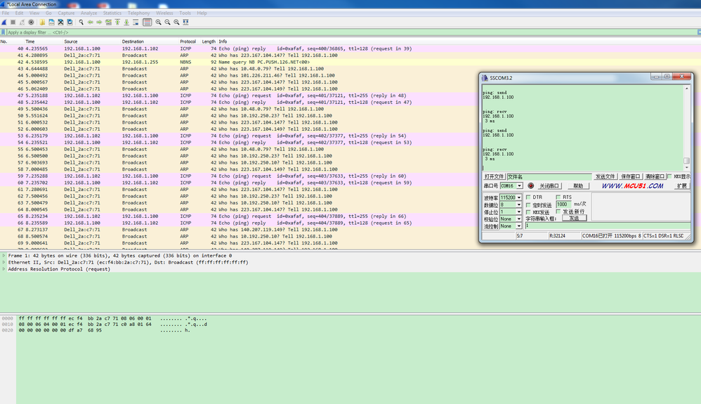

hi,
iam using the ping demo application in k66 from sdk2.0 but i can able to send the data which is available at output of the processor but iam not able to see the data in wireshark. if i make the phy loopback the tx data and enable signals are same, what is the problem iam not getting can help us.
1,549 Views
Hui_Ma
I also do a  test with FRDM-K66F board and lwip_ping_bm demo, with below test result:
The FRDM-K66F board could get response from PC( IP address: 192.168.1.100).
Wish it helps.
