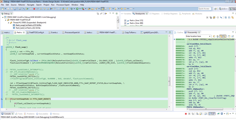

I have not verified the programming of the upper flash because stepping by instruction sets would take too long.
The problem occurs at the first call of pFlashCommandSequence from PFlashSwapCtl in flash_swap().
If I don't step through it by instruction set, the board will reset.
Let me know what you think.
Thank you,
Jason

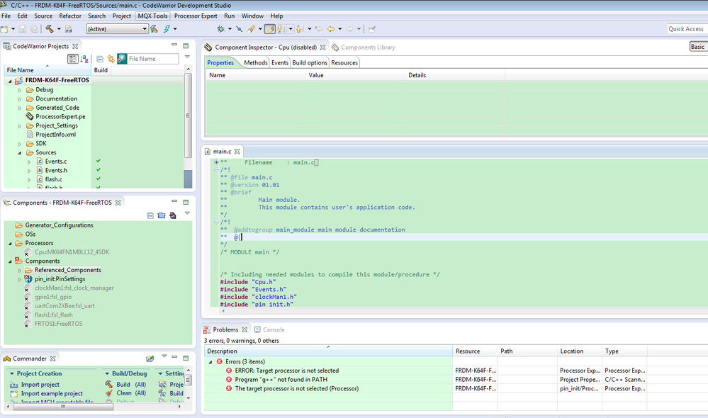

Hi Jason Philippi,
    Thank you for your more details.
    Please tell me what the IDE you are using? Codewarrior?
I use CW open it, it have a lot of errors:
About the component you attached, please give me a picture how to import to your project.
Thank you and wait for your reply!
Kerry

kerryzhou
Hi Jason Philippi,
      Sorry for my later reply, it caused a lot of time to test your project.
     Now, I found the root problem which caused your reset problem, it is the flash_task stack size is too small.
     Please do the following modification:
1. flash_callback definition changed to:
bool SIZE_OPTIMIZATION flash_callback(uint8_t currentSwapMode)
2.  CALLBACK_SIZE changed to
#define LAUNCH_CMD_SIZE 0x80 //0x200
#define CALLBACK_SIZE 0x130 //0x200 //0x1a0
3. ProcessorExpert.ld file
HEAP_SIZE  = DEFINED(__heap_size__)  ? __heap_size__  : 0x4000;
STACK_SIZE = DEFINED(__stack_size__) ? __stack_size__ : 0x2000;
4.FRTOS1_xTaskCreate stack size changed to 1000.
void flash_initTask()
    //flash1_InitConfig0.CallBack = (PCALLBACK)RelocateFunction((uint32_t)ramForCallback , CALLBACK_SIZE , (uint32_t)flash_callback);
        if(FRTOS1_xTaskCreate(
                flash_task, /* pointer to the task */
                "flash_task", /* task name for kernal awareness debugging */
                1000, /* task stack size */ //configMINIMAL_STACK_SIZE
                (void*)NULL, /* optional task startup argument */
                tskIDLE_PRIORITY, /* initial priority */
                &flash_taskHandle /* optional task handle to create */
        ) != pdPASS)
            for(;;){} //Ran out of heap
        else
After debug, you can find the code can run over PFlashSwapCtl function.
I also attached my modified project.
After you add it and build it, please modify ProcessorExpert.ld stack and heap size.
7,570 Views

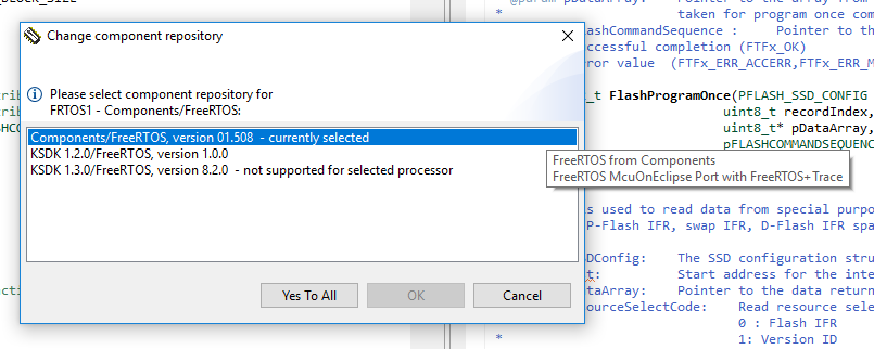

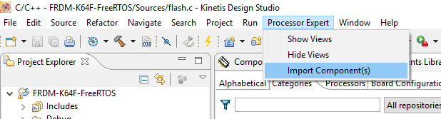

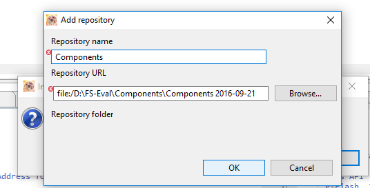

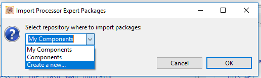

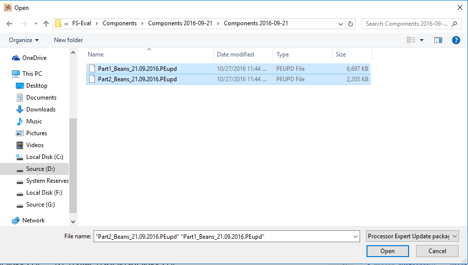

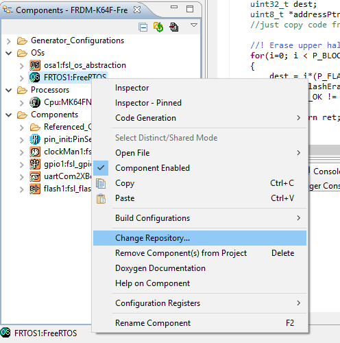

I am using Kinetis Design Studio 3.2.0 with KSDK 1.2.0 for the FRDM-K64F board.
You will need to install KSDK 1.2.0 for all the components except FreeRTOS.
I believe that should be possible through Help -> Install New Software...
Freescale KDS Update Site - http://freescale.com/lgfiles/updates/Eclipse/KDS
Select KSDK 1.2.0 Eclipse Update
To install FreeRTOS component from mcuoneclipse.com
Extract Components into workspace folder but not the project folder.
Select the two beans
Create a new component
This is where I have the components
If the FreeRTOS component shows a red X over it, then change the repository like this.
