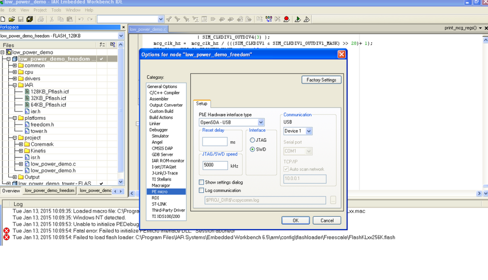

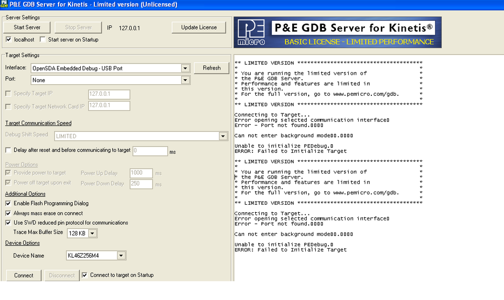

I have a FRDM-KL46Z kit,I use Embeded IAR,my problem that i can't connect to my device:untitled3.bmpss.bmpaa.bmp

gblack
Make sure you have the latest OpenSDA firmware installed. Also try uninstalling and reinstalling the driver from P&E Microcomputer Systems

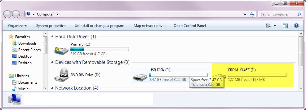

ivadorazinova
Hi nesrine mhiri,
please, check if you see it in your Computer.
If yes, look into the storage. There is info.htm and you see in the file information about versions.
It looks that you have not installed PEMicro OpenSDA Debug Driver.

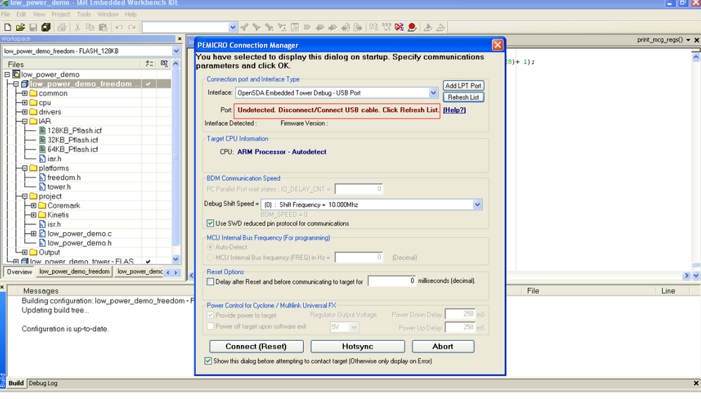

ivadorazinova
Hi nesrine mhiri,
It looks like problem with fixing usb drivers.
please, check jungo driver. Our colleague created great article about it. http://mcuoneclipse.com/2012/10/12/fixing-the-usb-drivers/

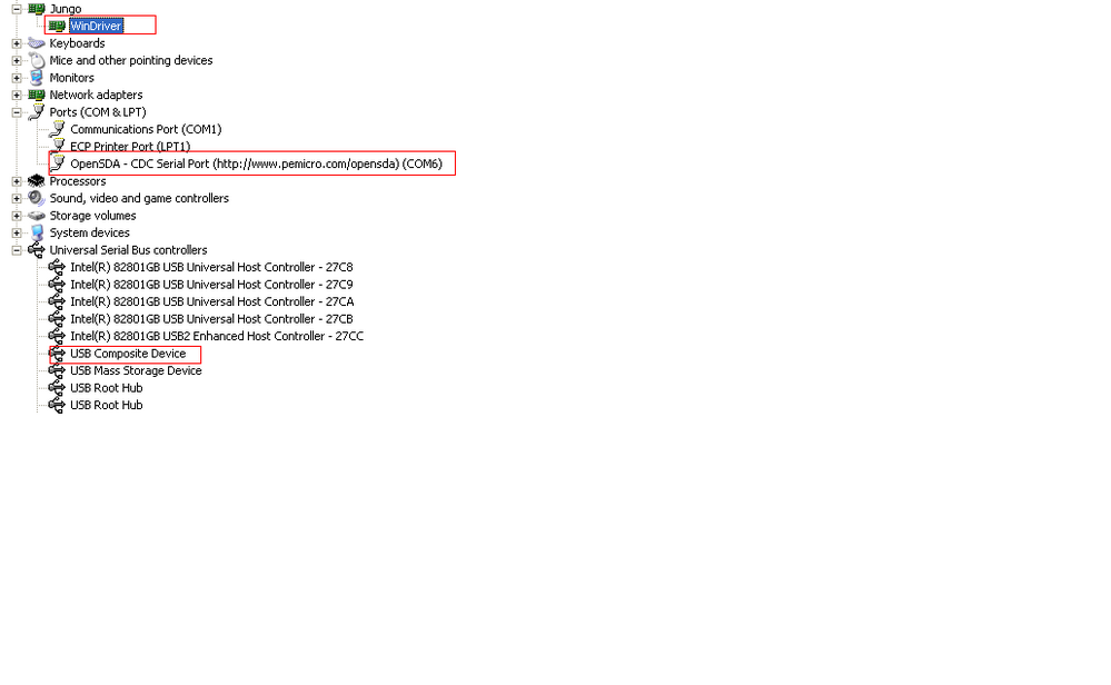

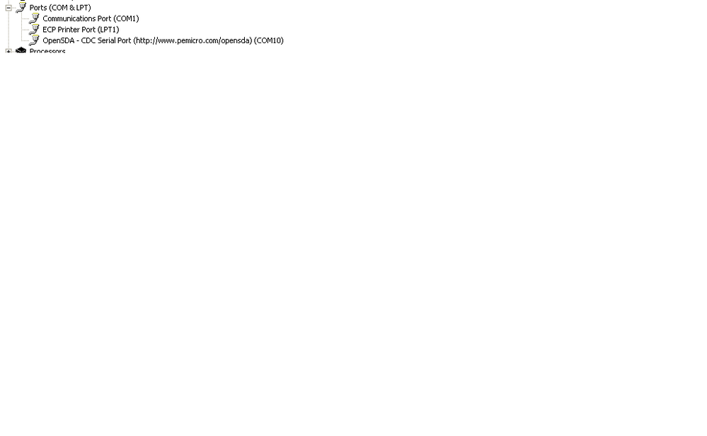

5,145 Views
omolin
Make sure you have loaded the Pemicro debug application in OpenSDA.
There is no way to tell if you have done this because you don't show the Pemicro device in device manager. The Serial port there is a general OpenSDA device so you could have no debug application loaded, or have CMSIS-DAP loaded possibly.

nesrinemhiri
really i don't find the problem,when i work with tower i usally use the JTAG pins but with FRDM kits am obliged to use the SDA ,please help me to connect to my kit
