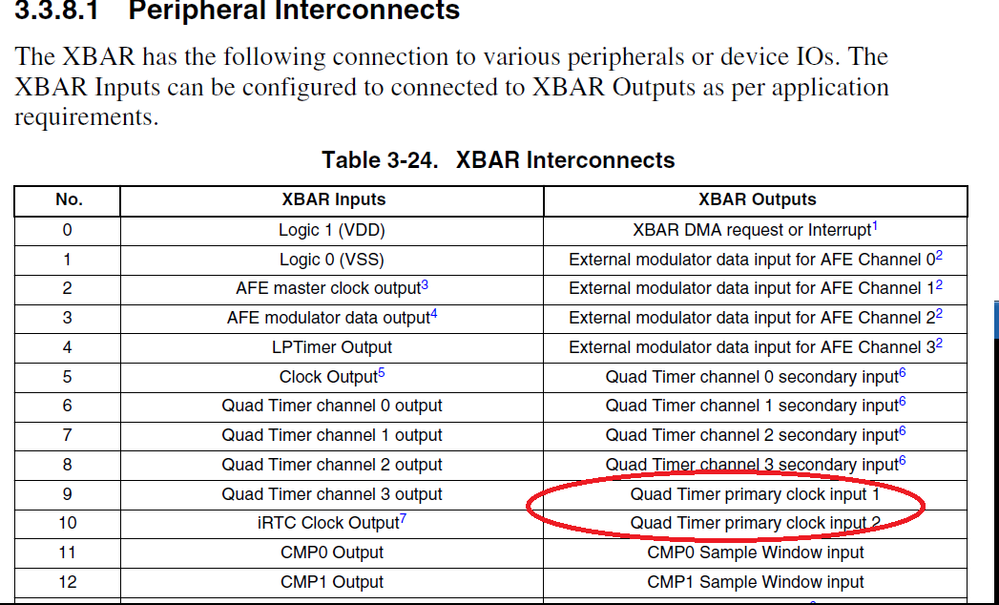

Currently i am developing an Flowmeter with mkm34 75MHz.
And i am trying to understand what would be the best option as clock.
In your opinion wich one is more stable PLL or FLL in this microcontroller?
As i could see the PLL needs to have an reference about 32khz is that right? i will not be able to multiply the high frequency xtal oscillator in this case?
Last Does anyone have examples on hou to achieve FEE and PEE using external xtal? i do not intend to use KSDK and i like to understand what is happening

Hi, Edriano,
I see that you want to get a stable tick for the quadTimer, the quadtimer can get a external clock from crossbar as it's primary clock source. Pls refer to the following part I copy from MKM34RM. In other words, you can connect a clock source from XBAR_IN0~XBAR_IN8 external pins and route the clock source to primary clock via crossbar. From example, you can connect the clock source to pin PTD0/PXBAR_IN2...., while you can set the crossbar as:
XBAR_SEL4|=0x02<<8; it is okay.
I never have test on my board, but I never have a test for the solution, pls have  a try.
Xiangjun Rong

xiangjun_rong
I forget to tell you that you have to set the SIM_MISC_CTL to select the IP_BUS, or clock from crossbar as the primary clock for quadTimer..
Xiangjun Rong
