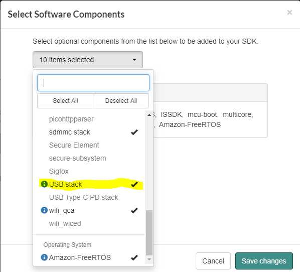

how do I get usb drivers for mk22 crystalless usb MCU? There are no examples for them, only for mk22fn528 but basically it have to be the same MCU.(MCUXpresso is used as IDE)
 If there are no drivers for that subfamilly of MCU it would be nice to have a huge banner that there is no driver support for that MCUs.

The problem is to set up USB registers. I am ok with low-level SPI,DMA or I2c, but USB is too time consuming to break through it. So driver+USB_stack were doing that job for me. But with that MCUs I faced with driver part absence.
 In that case it is simplier and faster for me to buy mk22fn526. But I woundering why NXP have no support for them and not informs about that situation.

I believe I understand now what you are referring to. Do you mean in the SDK for this part the stack is shown as not supported?
Yes I believe this is a bug in the SDK. I will report it as there should not be a problem in using the same USB stack.

I am able to download SDK but then it's impossible to add a USB midleware to the project on the creation stage .(and possible if mk22fn512 is choosen).
Are you using the MCU on a custom board or an evaluation board?
Custom made board. And it works fine with mkl43z MCU(as the are pin-2-pin compattible).

There is no difference in the USB in the K22FN128 and K22FN256 parts to the K22FN512. All can be used with crystal-less mode as device.
This means you should be able to use the K22FN512 sources for the USB part.
I have attached the USB OTG file from the uTasker project which works on all Kinetis parts if you are interested in low level settings for crystal-less mode. Search for the code with
