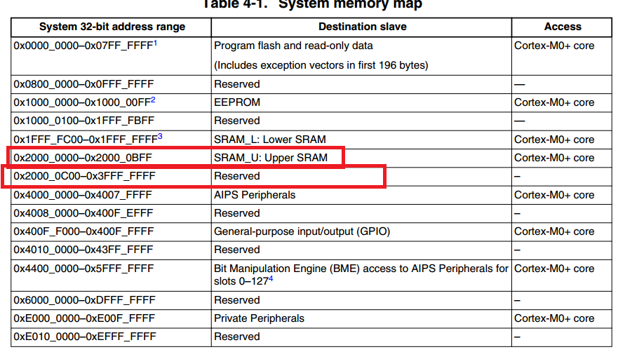

Dear  Expert:
please help confirm is there a bit_band SRAM(not AIPS) about KE02?Below is from the KE02 reference manual:

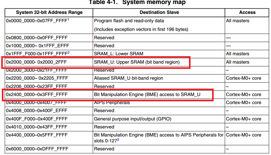

KE06 has the bit-band,below is from the KE06 refrence manual:
thanks for your great support.
1,189 Views
miduo
Actually all KE families employ Bit Manipulation Engine (BME) techniques to support bit banding.
