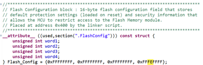

FelipeGarcia
Hi Kevin,
In order to change FSEC bit in MCUXpresso please first install MCUXpresso SDK of your device. You can download in the link below, or you can directly import it by clicking the Install New Plugin SDKs button in the IDE.
Welcome | MCUXpresso SDK Builder
Then, create a new project using new SDK project wizard or import example from SDK.
If you see startup_mke02z4.c file in the project you will find the Flash config section. These 16-byte section is the flash configuration field and it is related to the following snippet from the RM.
This means that to enable flash security you will need to change the highlighted byte from FE to FD.
I hope this helps!
Felipe

3,252 Views
Kratz
My board is a production PCB with a 32 pin chip instead of the being the demo board, so I don't think the SDK would work.  However, I did find the code you showed in the startup_mke02z4.c file.  I was able to change the hexadecimal "E" to a "D".  The Chip is now Secure.  Since there is no SDK, there should be no other way the security bytes in setup file could get overridden is there?
Thank you for your help!
3,276 Views
Kratz
It looks like setting up an attribute statement like this is needed.  I am not sure how to tell the compiler how to set location 0x400 as the place for this:
const uint8_t __attribute__((section("0x400"))) _cfm[0x10] = {
Also I read in the chip manual to add the array to the end of the vector table which I did on a bare metal project.  In MCUXpresso header file there was an incomplete vector table.  I have not figured out how to add the vector table this way either.
