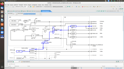

I've tried around a bit but I always end up with getting BOARD_BootClockRUN in red (drop down on top - in Clocks view). Hovering over it, reads:
ERRORS:
Requirement(s) not satisfiable.
And when I select PEE (in IMCG Mode), everything past the PLL block is red. I've tried to modify the PLL accordingly but am not able to. The PLL Frequency is set at 28.8MHz (and it shows a little red cross to the left of the number but doesn't provide any further hints) plus i don't seem to be able to change the frequency at all. Both PLL clock & PLL clock in Stop mode are set Disabled, PRDIV is set to /20 (is in red color) and VDIV is set to *48 (red colored also). I'm not sure how I can configure this correctly.
Can anyone assist me with this?

myke_predko
Senior Contributor III
@stdcerr
It may not feel like it but you're on the right track.  While you probably want to use PEE in your application, I suggest that you work up to it.
Personally, I would start with the goal of getting the crystal running - don't worry about the PLL just yet.
What happens if you select "PBE"?  You should be able to get the crystal running and then work on the PLL to get your application running at speed.
I know the clock wizard is cranky and there's no adequate documentation for using it - I have spent a lot of time clicking at things and then going back to the reference manual to try and figure out what's happening and how I want to get to where I'm going.
Let us know how you are making out on getting the crystal running and then, give us screen shots of the clock wizard so we can see where the problems lie.
Don't forget to check the "Error" box in the bottom right hand corner of the clock wizard - often the messages are useful (but you'll have to go to the reference manual to understand the messages).
Good luck,
myke

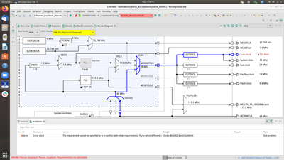

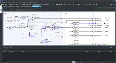

stdcerr
@myke_predko wrote:
@stdcerr
Thank you for the tips, it does look better already but seem not to be able to resolve the Core clock issue. How it looks so far:

myke_predko
Hey @stdcerr
That's helpful and I think it's starting to explain what's happening.
I *think* you have IRC48M enabled - correct?  What are you going to use it for?
Could I suggest turning off IRC48M internal oscillator and then selecting OSCCLK in OSCSEL to run from the 12MHz clock?
In the screen shot you've provided, I can't see what's happening with the System Oscillator - this is where you should be getting your 12MHz clock signal.  Once you have that, you should be passing it through MCGOUTCLK (this is PBE) and then to the Core Clock etc.
More importantly, you should be able to get out of the BOARD_InitBootClocks method.
When you get to this point, then you can start working on getting PEE working.

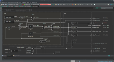

stdcerr
There, I've got a configuration without errors now but with PEE:
BOOM: Yeps, I was able to confirm that after I clkicked on Update Code, the function BOOT_InitBootClocks() now returns fine! Yay!
Only thing is, is it a problem that I'm using the internal 48MHz oscillator instead of the 12MHz system oscillator?

myke_predko
@stdcerr
Sorry, just saw this now - I replied directly to your reply to me but didn't read through the whole thread.
You're asking if it's a problem that you're running the Internal 48 MHz Oscillator instead of the external 12 MHz.  That depends on your application, if you're going to use the Kinetis for anything that requires a precision clock (USB & Ethernet being  big ones and you may have issues with the UART).
If you aren't using any of these peripherals, then you can delete the 12 MHz crystal and use the two pins for IO.
Personally, I would recommend getting the crystal working.  Maybe you don't need it now...

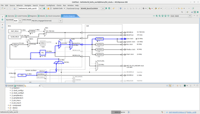

stdcerr
@myke_predko wrote:
@stdcerr
Yes, I'll need the crysral working because I'm going to be using this for CAN which needs precision timing.
I have now changed the OSCSEL to the 12MHz oscillator, deactivated the PLL, changed the PLLS to FLL but can't seem to get the numbers right for the Core clock. Do you have any further hints? What I have now looks like:

myke_predko
Hiya @stdcerr
Looking at your clock diagram, you're running your system with the SLOW_IRCLK and not the 12 MHz Crystal.
Follow the heavy lines on the diagram because that's the clock path - You've specified "FEI", which is FLL Engaged Internal which is what you're seeing - the internal clock going into the FLL and then into MCGOUTCLK Mux.
I think you want to try "PBE" which will use your external clock, bypass the PLL, go directly to MCGOUTCLK and you'll have your core/system clocks running at 6 MHz.
When I look at your PLL values (/ 20 * 50 - divide by 20 and then times 50) I don't think they're valid for the clock register.  Regardless, we can look at that later, let's get PBE working.

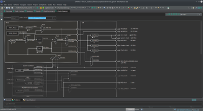

stdcerr
e we go:
PLL = /4*40:
I think this should/could/would do the trick, shouldn't it?

myke_predko
@stdcerr
Yes, that's more in line with what I'm looking for.

stdcerr

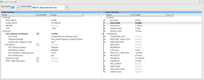

So yes, I tried OPBE now and I've got this:
As for the clocks table, it looks like:
 One little thing that I realized is, Core clkock was at 120MHz with a little padlock and showed an error, I then double clicked on it in the clocks table, which removed the error (and padlock)and it then changed to 12MHz.
So with the above setup, it still gets stuck at
    /* Wait for CLKST clock status bits to show clock source is ext ref clk */
    while ((MCG->S & (MCG_S_IREFST_MASK | MCG_S_CLKST_MASK)) !=
           (MCG_S_IREFST(kMCG_FllSrcExternal) | MCG_S_CLKST(kMCG_ClkOutStatExt)))
10,352件の閲覧回数
stdcerr
wait, i modified the OSC mode and selected
  • Using oscillator with external crystal (low power)
instead of
  • Using external reference clock
which I think solved the problem!
