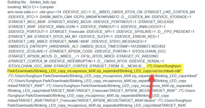

I debugged the program and got the following error. I tried formatting the computer, and even though I carried out the import and export processes without any problems, the results are not normal. I am wondering how you can handle it.

15:11:52 **** Build of configuration Debug for project Blinking_LED_copy ****

arm-none-eabi-c++: error: Park/Downloads/Blinking_LED_copy_mcuxpresso_k64f.zip_expanded/Blinking_LED_copy/Debug/linker-script-debug.ld: No such file or directory

Check your include path settings: there is a strange one with a dot (.zip) plus // in it:
That does not lock correct.

You need to check your project's includes because the problem is that it is not finding the linker-script-debug.ld file.
You can see the project includes by right-clicking on the project, then Properties>C/C++ Build>Settings.
Where did you get this project? it has a weird folder name with a dot in it (Blinking_LED_copy_mcuxpresso_k64f.zip_expanded). Maybe that is causing problems. I have never worked directly on a folder with a dot in the name but maybe windows is having a hard time using that.
I would recommend to remove the project from mcuxpresso, rename the folder to just Blinking_LED_copy_mcuxpresso_k64f, and import the project again. Then check the includes to see if the builder is referencing the correct paths.
