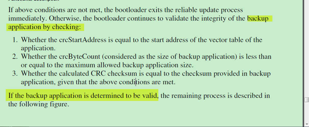

In "Kinetis Bootloader v2.0.0 Reference Manual" Page 156, its description is:
1. Whether the crcStartAddress is equal to the start address of the vector table of the application.
question: the application is referred to main application or backup application?
The package "NXP_Kinetis_Bootloader_2_0_0" source code tells that it refers to the main application , however, what is the purpose for the crcStartAddress in BCA of backup application code to contain the address of main application code?
Any of guys can explain? Thanks!

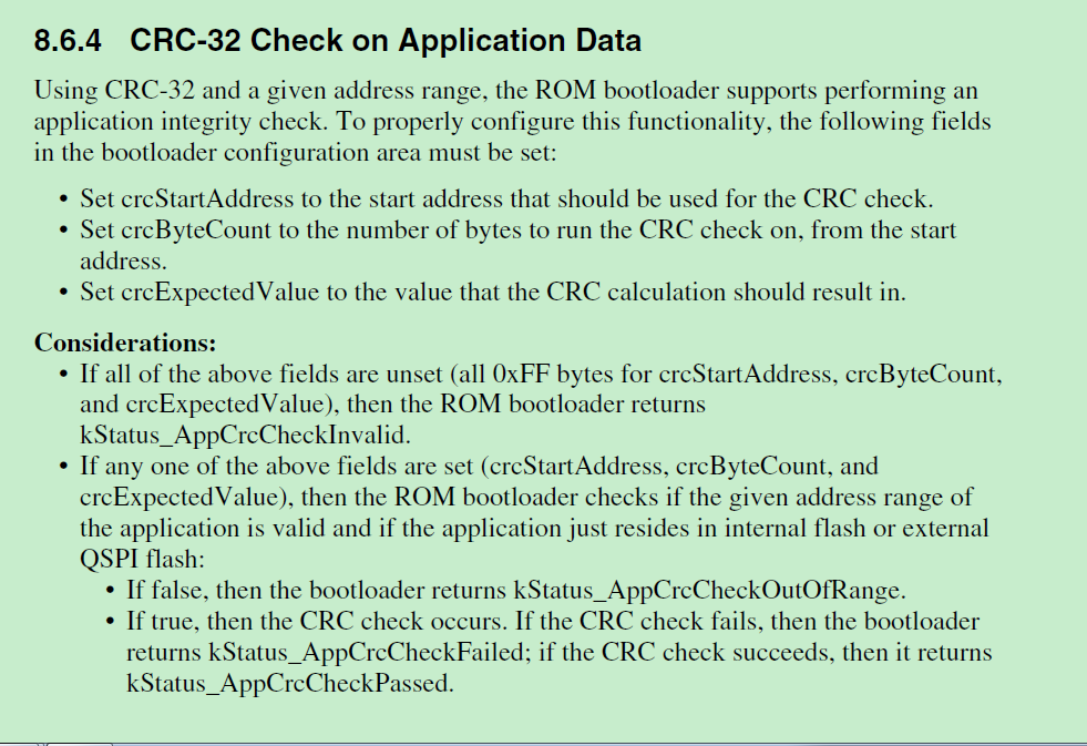

   From the Kinetis Bootloader v2.0.0 Reference Manual.pdf description, page 156,
This application should be the backup application.
2. what is the purpose for the crcStartAddress in BCA of backup application code to contain the address of main application code?
  Even from the ROM bootloader CRC description,
CRC should used to check the application integrity. If you check the backup application, the crcStartAddress should be the backup application address.
You said source code tells that it refers to the main application, could you point which source code, and tell me the detail information.
Thank you!
Kerry
