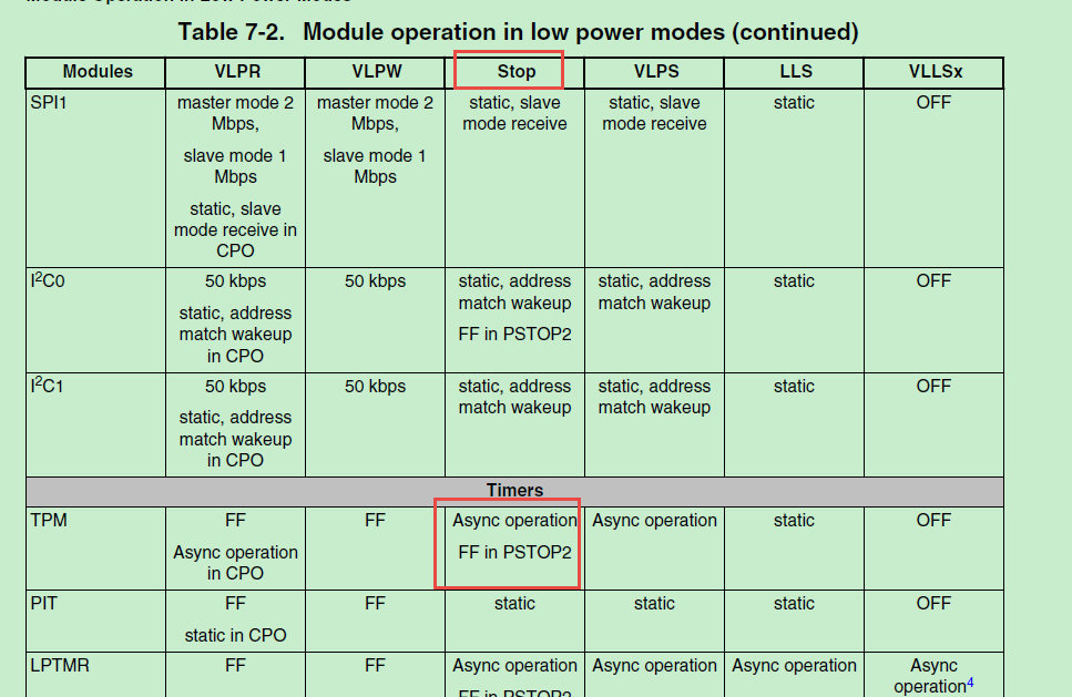

     I don't know which chip you are using, now take MKL25 as an example:
You can find in the STOP mode, async operation, the TPM is full function in PSTOP2, it can generate PWM if you don't use the interrupt. If you use interrupt, the STOP mode will be wake up.

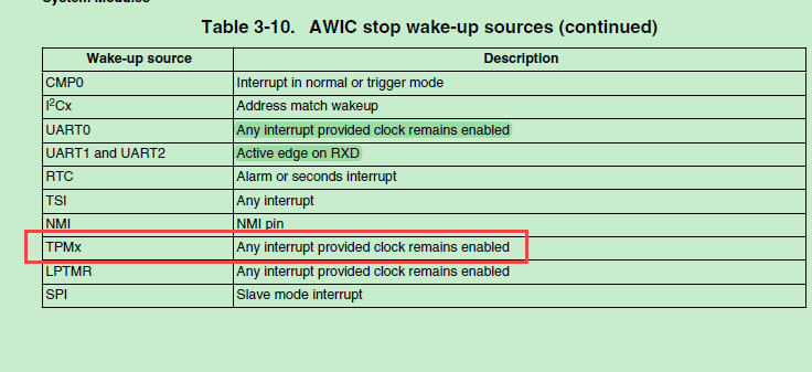

current consumption is too large in partial stop 2 mode. I tried partial stop mode, but seems to be that tpm interrupt doesn't wake cpu up. Shoud it be possible to use tpm interrupt to wake us from stop mode ?

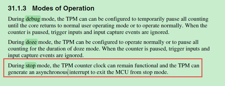

    Yes, the TPM interrupt can wake up the stop mode:

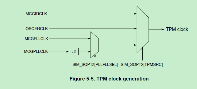

But take care, you must make sure, the clock which you are using for TPM can still work in the stop mode.

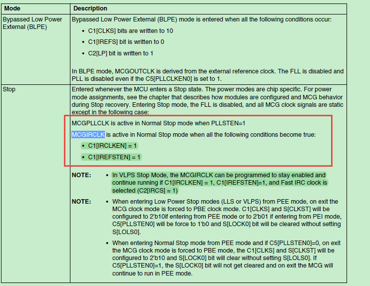

I got it working with
OSC0->CR |= OSC_CR_EREFSTEN_MASK;

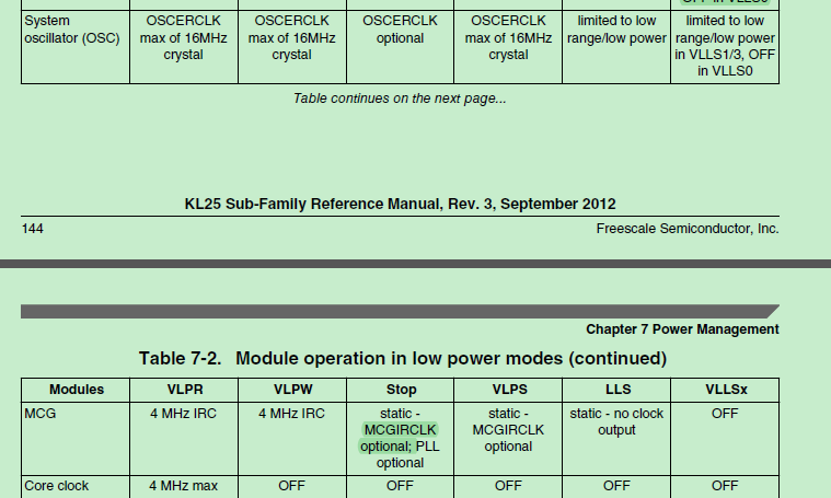

  Please check these information from the reference manual:
So, you can use MCGPLLCLK with PLLSTEN=1, MCGIRCLK with C1[IRCLKEN]=1 and C1[IREFSTEN] =1, or OSCERCLK with EREFSTEN=1.
