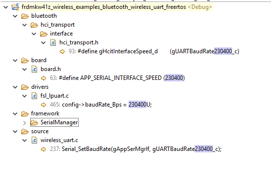

stephanie_m
Using the examples with and without the wireless connectivity framework it was possible to set the frequency of your interest in the KW41. For example, if you are trying to use it in the wireless uart demo you will need to modify the following files.

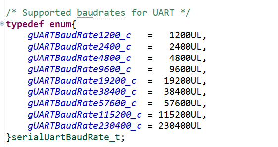

stephanie_m
You can check in the serial manager the following definitions where the 230400 it's included.

koonlee
Hi Estephania,
serialUartBaudRate_t only define up to gUARTBaudRate230400_c. Is it possible to run at 230400x2 => 460800?
