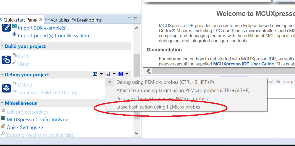

Hi All,
I'm working for the first time with a MK64 microcontroller, that comes in the factory preprogrammed with a bootloader.
Anyway, my first prototypes seems not to be able to boot; I've checked my schematic and PCB with no error, and now the next step is to check if the MCU is programmed or not.
How can I do that as a single operation? I've a PEmicro Cyclone FX that is compatible with Kinetics MCUs, but on MCUXpresso I've found only the complete procedure of Erase/Check/program that is not useful in my case.
Is there a different tool that is able to execute the simple memory blank check?
Thanks to all that will help me!!!

MCUxpresso can't check memory blank. But it can chip erase only or program only.
If the erase is success. You can sure that the the flash is erased and checked.
If you want to check by other tool, please visit PEmicro's tools.
