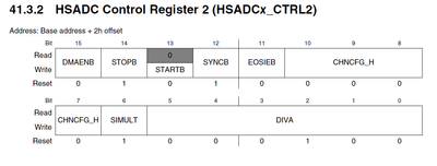

xiangjun_rong
I have check the errata of KV58, I have not seen any item which mentions the ADC hardware bugs.
https://www.nxp.com.cn/docs/en/errata/KINETIS_V_1N86P.pdf
Based on my experience, maybe there is issue if you clear the SIMULT bit in the HSADCx_CTRL2 register.
Pls use the following configuration and have a try.
hsadcConfigStruct.dualConverterScanMode = kHSADC_DualConverterWorkAsTriggeredSequential;
hsadcConfigStruct.enableSimultaneousMode = true;    //Rong write, set SIMULT bit
hsadcConfigStruct.resolution = kHSADC_Resolution12Bit;
hsadcConfigStruct.DMATriggerSoruce = kHSADC_DMATriggerSourceAsEndOfScan;
hsadcConfigStruct.idleWorkMode = kHSADC_IdleKeepNormal;
hsadcConfigStruct.powerUpDelayCount = 18U;
// Initialize each converter
HSADC_Init(HSADC0, &hsadcConfigStruct);
HSADC_Init(HSADC1, &hsadcConfigStruct);
If you change the code and the ADC will sample in parallel mode, so the ADC triggering signal has to change, pls check the code yourself.
I suggest you separate the motor for safety, and only test the ADC, you can sample the ADC to a big array and check if the phenomenon happens or not.
I do not guarantee it solve your problem, anyway, pls have a try.
XiangJun Rong
1,916 Views
xiangjun_rong
For the HSADC module, each hsadc has two adc converters: HSADCxA and HSADCxB, if the HSADCx_CTRL2[SIMULT]=0, the HSADCxA and HSADCxB work independently, each converter requires respective triggering source, per my support experience, only HSADCxB has issue, the HSADCxA does NOT has issue. Pls check if your phenomenon matches what I said.
