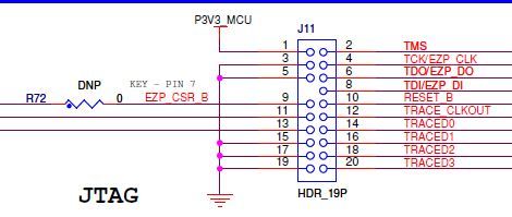

I'm trying to program my TWR-K60N512 by kl25z (using that as a cmsis-dap interface for flashing with openocd) but I have the next error: (the program remains "in procedure 'init') Whst's the problem? What kan I do?
1,638 Views
dariojimenez

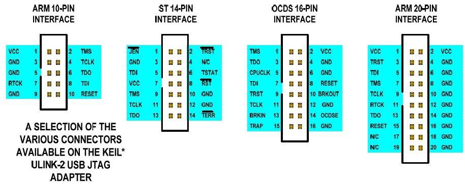

Finally, I have solved it by myself. The problem was that the TWR-K60N512 have a jtag connector of 20 pins but actually use it like a 10 pin jtag connector. (See the pictures)
JTAG TWR-K60N512
COMPARISON
