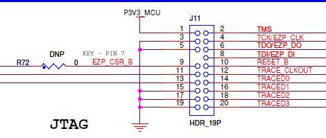

I'm trying to program the flash of the TWR-K60N512 by the debugger arm-usb-ocd and openocd but I have the next error. Any solution for that??

Info : clock speed 50 kHz
Error: JTAG scan chain interrogation failed: all ones
Error: Check JTAG interface, timings, target power, etc.
Error: Trying to use configured scan chain anyway...
Error: k60.cpu: IR capture error; saw 0x0f not 0x01

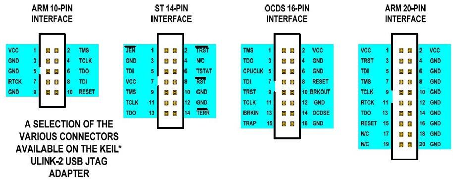

Finally, I have solved it by myself. The problem was that the TWR-K60N512 have a jtag connector of 20 pins but actually use it like a 10 pin jtag connector. (See the pictures)
JTAG TWR-K60N512
COMPARISON
