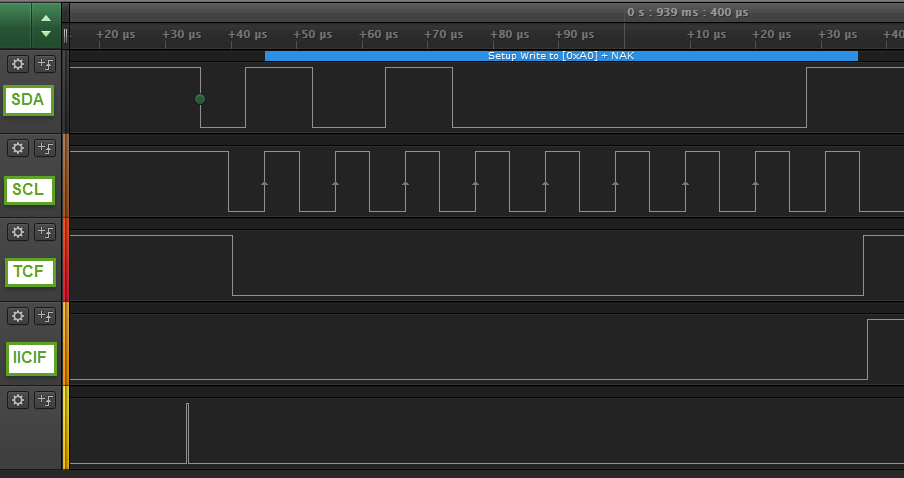

Hello.
I am currently writing an I2c Baremetal function.
and after a long time testing and analyzing the data i could realize that   ITCF and  RXAK flags does not work as i thought.
after sending a byte to I2c if i try to test either TCF and RXAK both of them are true and i start to overwrite the data register. if i use the code below nothing works. i already found a way to solve that testing the IICIF flag. this one works.
but my question is. doesnot this flags works at all? i am assuming something wrong?

Hello Edriano Araujo:
As you will find in most of the I2C projects with Kinetis, in polling mode the IICIF flag is used instead of the TCF flag. The reason for this is that TCF is only valid for a specific period of time during the byte transfer and it is a read only flag. TCF does not clear immediately after writing to the I2Cx_D register but until the I2C peripheral starts sending the clock signal. In comparison the flag IICIF can be cleared by the user and it must be 0 before sending any byte.
The picture below shows what I mean, by reflecting the values of TCF and IICIF in digital pins during a byte transfer; the pulse at the bottom is another pin which is toggled just after the write to I2Cx_D.
The next code might work when polling TCF, but you will notice that it is redundant (waiting while TCF = 1 then waiting while TCF = 0
  I2C_HAL_SendStart(I2C0_BASE_PTR);
  I2C_HAL_WriteByte(I2C0_BASE_PTR, 0xA0);
  while((I2C0_S & I2C_S_TCF_MASK) == I2C_S_TCF_MASK){}
  while((I2C0_S & I2C_S_TCF_MASK) == 0){}
  I2C_HAL_WriteByte(I2C0_BASE_PTR, 0xB0);
  I2C_HAL_WriteByte(I2C0_BASE_PTR, 0xC0);
  I2C_HAL_SendStop(I2C0_BASE_PTR);
I hope this helps to clarify.

Edrianocarlos
Hello Stanislav.
Here is my routine. it is blocking read and now it is working perfect but i had to read the interrupt flag.
My question was aboult why reading he TCF flag it does not work? wasnt this flag for this?

Edrianocarlos
Hello, Jorge.
thank you very much for your replay.
I have done the exactly same test as you do and realized that. I am trying to use more the hall and drive function present at the KSDK. But for many reasons i like to make my own rotines and for that i read the reference manual.
It would save a lot of time if there was a better documentations regarding this. If you read the manual and intend to make a pooling rotine TC would be the choice but does not work as documented.
here is the rotine i made to read the MMA8451. hope this help people with the same problem
