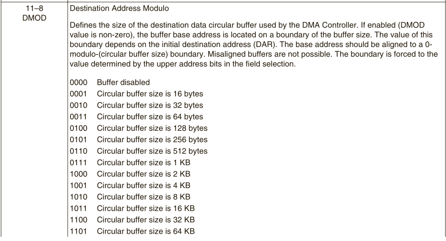

I use KL16  DMA  for uart transfer .
When i use DMA, i enable  DMOD (Destination Address Modulo) ,and set circular buffer size 16 bytes(DMOD writed 0000) ,.
After  uart  trans  16  bytes,  receive_buffer will  lost the last data(receive_buffer[15]), and  BCR value  is right.
The same  thing happens when DMOD be set to 0010.Will lost receive_buffer[31].1.png2.png

Hi Yi
Ensure that the memory that you are receiving the data to is also modulo aligned. That is, if you use modulo 16 make sure that it starts on a boundary that is divisible by 16; eg. 0x20000000, 0x20000010, 0x20000020, etc. when in SRAM.
Mark
