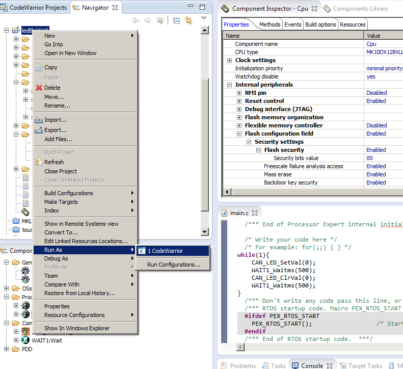

Hi all,
    I am trying to secure kinetis k10 microcontroller. Normally my project works without any problem. If I enable the security option from processor expert, my code does not work. The only thing that I do is enableing the security checkbox below. Probably my code does not start. Any suggestion please...

santiago_gonzal
Hello Okan,
Are you trying to program or to debug it?
If you just program the board (You can try with Flash file to target in CodeWarrior, the blue thunder icon) it should work.
Santiago
5,469 Views
okaner
Dar Santiago,
       Thank you very much for your answer. Actually I was not debugging but using "run as" to program the mcu. Programming with thunder icon worked.

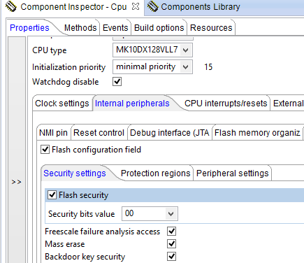

okaner
Dear Erich,
    I made a new just LED blinking project. Normally it works fine. After securing, it does not blink. I really dont know why.
Okan,
5,469 Views
okaner
you can find my project settings for security at below,
