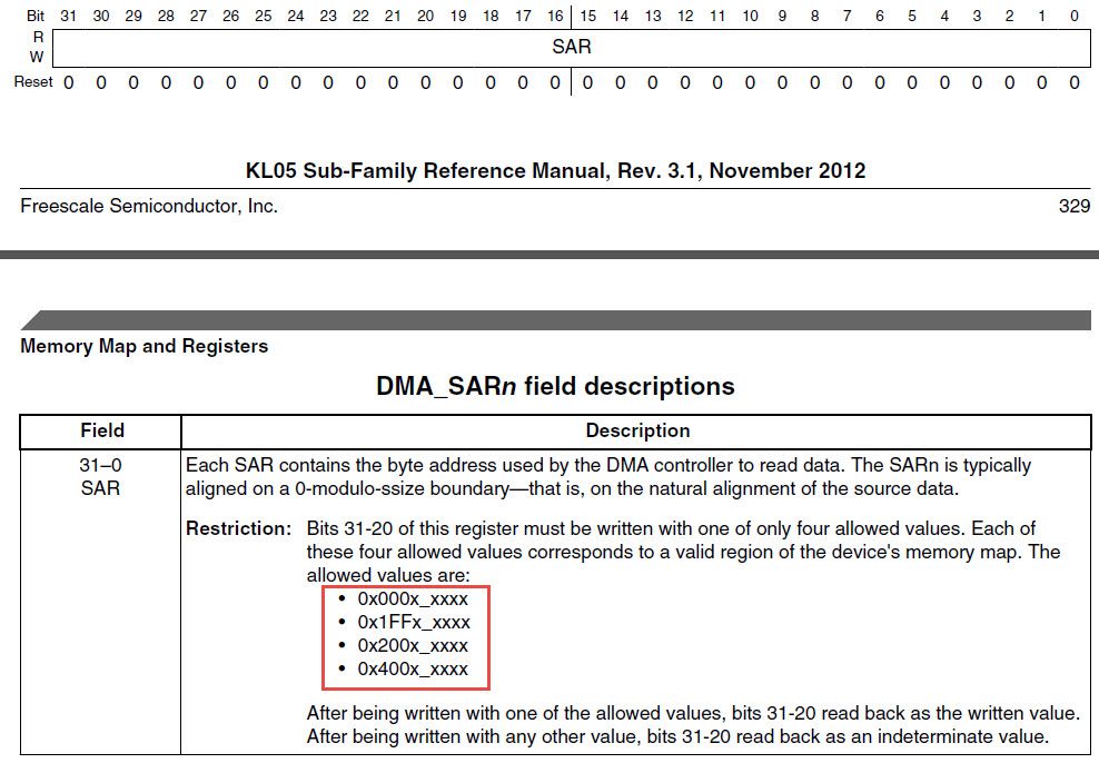

jeremyzhou
Hi Barry,
I've had a brief look through your code and I didn't find the any noticeable errors except the source address definition.
You can find the limitations of the source address value in the RM, just as the Fig1 shows. So I need to confirm the address of the u32ADCcontrol[0] whether follow the rule or not.
                                                                          Fig 1
Ping
8,964 Views
barryb
Thank you for your response.
u32ADCcontrol[0] is located at memory location 0xFFFFE08 ->0xFFFFE14.
I don`t think this is the real problem because everything is working fine after the first DMA0 activation. It looks like the module doesn`t accept the BCR change when the last DMA cycle has ended.
