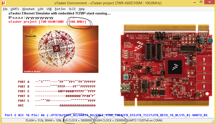

I think that your code is aiming at setting 100MHz core. Below is the same setting which the uTasker K60 tower kit simulator shows - it uses this code (as comparison).
    MCG_C2 = (MCG_C2_RANGE_8M_32M | MCG_C2_LOCRE0);                      // select external clock source (with reset on clock loss)
    MCG_C1 = (MCG_C1_CLKS_EXTERN_CLK | MCG_C1_FRDIV_1024);               // switch to external input clock (the FLL input clock is set to as close to its input range as possible, although this is not absolutely necessary since the FLL will not be used)
    while ((MCG_S & MCG_S_IREFST) != 0) {                                // loop until the FLL source is no longer the internal reference clock
    while ((MCG_S & MCG_S_CLKST_MASK) != MCG_S_CLKST_EXTERN_CLK) {       // loop until the external reference clock source is valid
    MCG_C5 = ((CLOCK_DIV - 1) | MCG_C5_PLLSTEN0);                        // now move from state FEE to state PBE (or FBE) PLL remains enabled in normal stop modes
    MCG_C6 = ((CLOCK_MUL - MCG_C6_VDIV0_LOWEST) | MCG_C6_PLLS);
    while ((MCG_S & MCG_S_PLLST) == 0) {                                 // loop until the PLLS clock source becomes valid
    while ((MCG_S & MCG_S_LOCK) == 0) {                                  // loop until PLL locks
    SIM_CLKDIV1 = (((SYSTEM_CLOCK_DIVIDE - 1) << 28) | ((BUS_CLOCK_DIVIDE - 1) << 24) | ((FLEX_CLOCK_DIVIDE - 1) << 20) | ((FLASH_CLOCK_DIVIDE - 1) << 16)); // prepare bus clock divides
    MCG_C1 = (MCG_C1_CLKS_PLL_FLL | MCG_C1_FRDIV_1024);                  // finally move from PBE to PEE mode - switch to PLL clock
    while ((MCG_S & MCG_S_CLKST_MASK) != MCG_S_CLKST_PLL) {              // loop until the PLL clock is selected
The input to achieve this is:
    #define CLOCK_DIV            16                                      // input must be divided to 2MHz..4MHz range (/1 to /25 possible)
    #define CLOCK_MUL            32                                      // the PLL multiplication factor to achieve operating frequency of 100MHz (x24 to x55 possible)
    #define SYSTEM_CLOCK_DIVIDE  1                                       // 1 to 16 - usually 1
    #define BUS_CLOCK_DIVIDE     2                                       // 1 to 16
    #define FLEX_CLOCK_DIVIDE    2                                       // 1 to 16
    #define FLASH_CLOCK_DIVIDE   4                                       // 1 to 16
Mark
