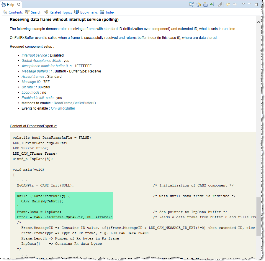

I used the CAN function.
But the RX code just run one time.
How to fix the question.

I can not build your project in KDS or CodeWarrior.
Would you please try to test the receive function descripted in "Receiving data frame without interrupt service (polling)" example?
  MyCANPtr = CAN1_Init(NULL);                                     /* Initialization of CAN1 component */
  while (!DataFrameRxFlg) {                                       /* Wait until data frame is received */
    CAN1_Main(MyCANPtr);
  Frame.Data = InpData;                                           /* Set pointer to InpData buffer */
  Error = CAN1_ReadFrame(MyCANPtr, 0U, &Frame);
