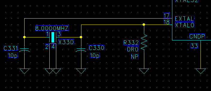

Hi-
I have problem to re-enable the external crystal after resuming back from VLPR mode on my k20d50m custom board. The k20 is clocked by 8MHz crystal with two ends connected to ground via a capacitor valued 10pF (both boards with and w/o them populated are tested, same results).
The crystal has no problem to start  after powering on but stops to oscillate on the way back to normal mode (via APIs of MQX4.1).
My IAR debugger hangs at
    /* MCG_C1: CLKS=2,FRDIV=3,IREFS=0,IRCLKEN=0,IREFSTEN=0 */
      MCG_C1 = (uint8_t)0x98U;
When the mode is changed from FBI to FBE and external clock is expected.
I traced the clock output of 8MHz crystal and found no oscillating there after
      /* OSC0_CR: ERCLKEN=1,??=0,EREFSTEN=0,??=0,SC2P=0,SC4P=0,SC8P=0,SC16P=0 */
      OSC0_CR = (uint8_t)0x80U;
in FBI mode. The only I can see is the voltage on XTAL0 jumps back to 3V from 0V.
The external clock is stopped on the way to VLPR which seems to be OK to me.
What is the reason to cause the crystal NOT to start again? it is the HW or SW problem?

Other than register settings above, any crystal circuit design problem could lead to clock re-starting failure? After  OSC0_CR = (uint8_t)0x80U, I see XTAL0 of K20 jump to 3V from 0V but there is no clock showing up. I think it is different to start oscillation between power-on and sleep-resume. Anything could go wrong?

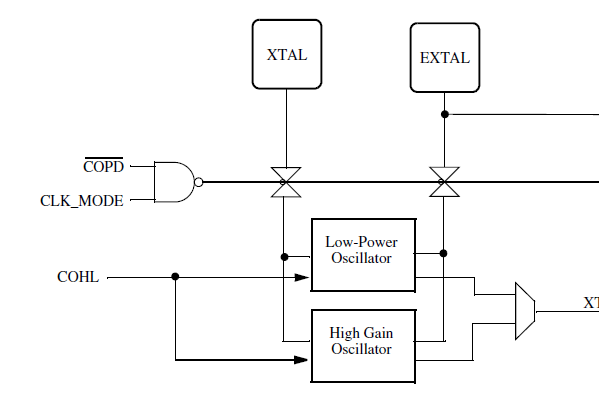

It seems like the problem is resolved by setting MCG_C2 = (uint8_t)0x25U in FBE mode above. By user manual, it is changed from high gain to low power for oscillator. Maybe it is the needed configuration for my crystal circuit. Can you please explain why?
thanks!

Regarding the the setting of the MCG_C2, which you set as MCG_C2 = (uint8_t)0x25U in FBE, I think the disputable bit is the HGO bit, which is defined as the following:
HGO High Gain Oscillator Select:
Controls the crystal oscillator mode of operation. See the Oscillator (OSC) chapter for more details.
0 Configure crystal oscillator for low-power operation.
1 Configure crystal oscillator for high-gain operation.
But I do not have detailed description about the circuit and function except for the User manual of K20. I copy it here:
26.8.2.3 High-Frequency, High-Gain Mode
In high-frequency, high-gain mode, the oscillator uses a simple inverter-style amplifier.
The gain is set to achieve rail-to-rail oscillation amplitudes. This mode provides low pass
frequency filtering as well as hysteresis for voltage filtering and converts the output to
logic levels. In this mode, the internal capacitors could be used.
26.8.2.4 High-Frequency, Low-Power Mode
In high-frequency, low-power mode, the oscillator uses a gain control loop to minimize
power consumption. As the oscillation amplitude increases, the amplifier current is
reduced. This continues until a desired amplitude is achieved at steady-state. In this
mode, the internal capacitors could be used, the internal feedback resistor is connected,
and no external resistor should be used.
The oscillator input buffer in this mode is differential. It provides low pass frequency
filtering as well as hysteresis for voltage filtering and converts the output to logic levels.
I checked the clock part of DSC, it has the diagram:
But the DSC do not give detailed explanation either for the theory of :"low power Oscillator" and "High gain Oscillator".
If someone has knowledge about the topic, welcome share knowledge and inf on the open community platform.
Xiangjun Rong
