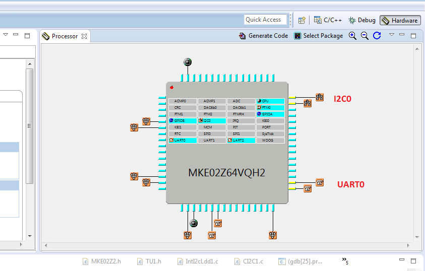

I've configured with KDS 3.0 my FRDM-MKE02Z as shown
If I use I2C0 (master) and UART0 separately in my application everything goes well. I'm able to Rx/Tx information through both modules. However, while I access to my I2C slave (an MCP23017 I/O Expander) and I receive some information on UART0 Rx (by a modbus polling), the CI2C1_SendBlock function returns an ERR_BUSY error. And the MCP cannot recover anymore.
UART0 share pins with I2C0 but PE has not notify of any errors so I assume that pinmux are set correctly. What could be the problem?
I'd appreciate any help.

Hello Gaston
Normally all peripherals can operate in parallel so I don't recommend doing anything like disabing one in order to use another.
What peripheral drivers and operating system are you using? If you are using example drivers you will need to investigate each one's operation because they may have been created to illustrate a single case but not be able to work in a real project environment without modification/re-design. Are they pollig or are they interrupt driven? Are then blocking or non-blocking?
How much RAM is used in the system (the KE02 has only 4k RAM) and do you have any issues with stack overflow?

The pin muxing on the KE devices is automatically controlled by the peripheral functions (eg. when the UART is enabled, its pins are connected as long as there is not another peripheral enabled which has a higher priority than it on the pins in question).
Therefore I don't think that you have a pin muxing issue but rather a software/concept issue when both peripheral are operating together.
Indeed, both peripherals must to work together. What software/concept should I take into account?
ie. should I Dissable/Enable the UART module before using the I2C?

Mark, I think the problem is how I use CI2C1 component create by PE. I implemented my own I2C (GPIO based) and everything goes well. Currently I have no time to investigate what going on with CI2C1 but I've noticed that its description indicates a 'Legacy' High Level Component. What does it means? Will it be removed in future versions and should I avoid to use it? I'm not able to find much support about this.

Solved! I had found a silly mistake in my code...
It's a long time ago post but I've just realized it was not answered. Mark, thank you for helping.
